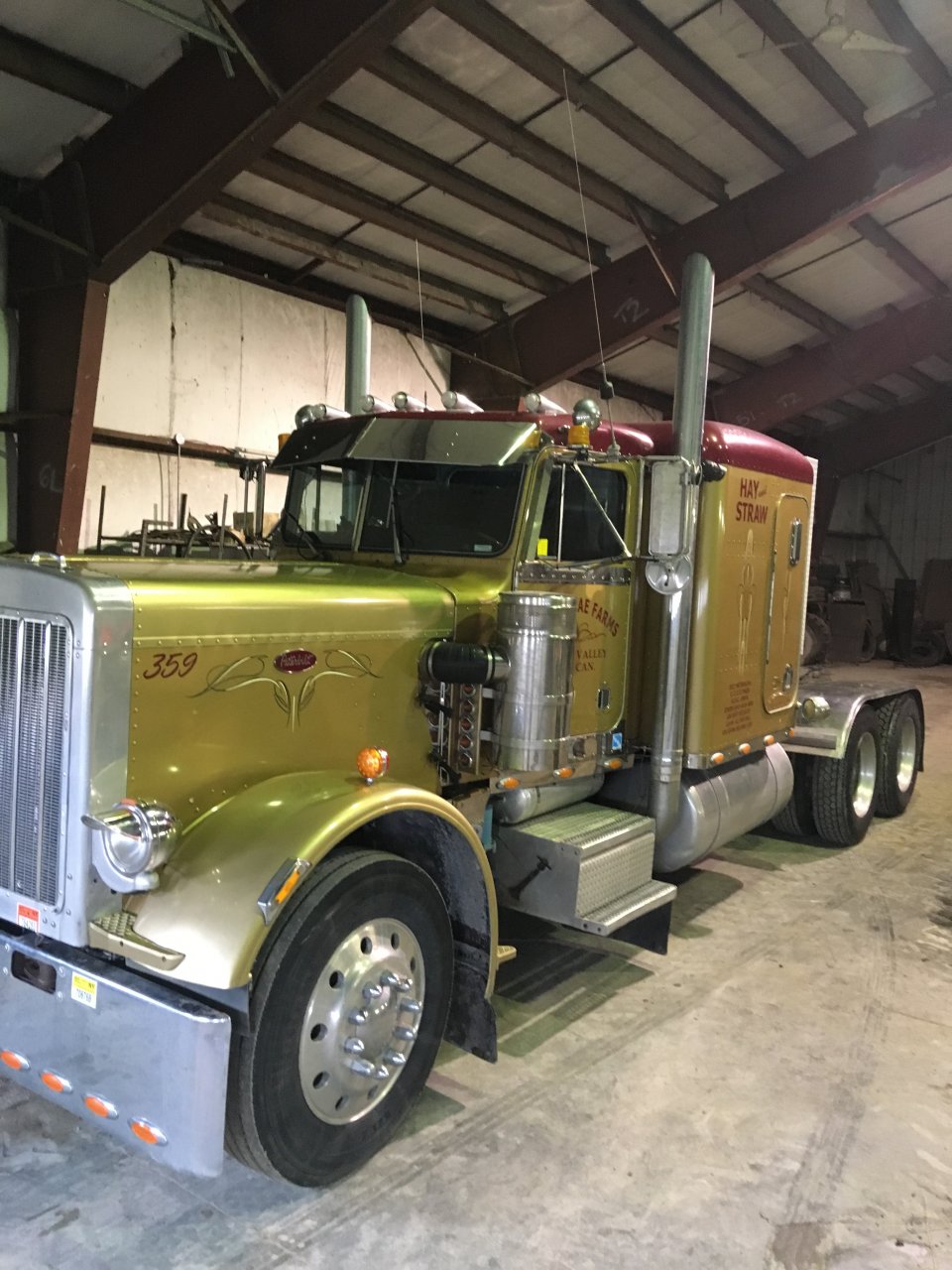

    Iv got the old cap removed and the new one fitted up. The fit up was awful. They shot way to much fiberglass in the mold in the corners. It wouldn't even go on the body till I spent a few hours trimming excess fiberglass from the inside of the cap. Got it sitting where I want it and just temporarily holding it in place with 4 3/16 bolts. It will come off again before final assembly.

    Iv been picking away at removing rivets for probably a couple weeks now every time I had a spare few mins if knock some out. Had a lot of rain the last few days witch made it too wet to get in and out of the construction sites I'm delivering to gave me me some extra time to spend on it this week. I planned on getting the roof cap fitted today as well as change the air compressor mounting gasket on the mack as it's starting to sleep. Didn't get to that today though as I didn't anticipate spending 3 hours just getting the roof cap to fit on the truck....lol. my goal is to have the truck done in a year. Witch is a pretty tight timeframe for this scale of project when you still have to work to make money...lol but normally every winter I take some time off around January February. I want to paint the truck around that time when I can divote a solid a chunk of time to it. Witch may seem a little backwards but to me the mechanical is easier to break up into smaller projects when I'm busy.
    It's not been fun...lol I can't say I would be happy to do it again. It will make me happy though to not have rain leaking into the inside of the truck anymore though

    iv got the roof cap finnished now. ill have to try to grab some more pictures for the thread.
    i ended up using windshield urethane as sealent. i talked with my body supplyer and kinda determined that might be the be the best option. they had several body panel bonding adheasives but they warned that if i were to ever need to take it back apart again for any reason that it would probably be a real challenge to get it apart without absolutely destroying everything. although the windshild urethane probably would still be a pain to get apart might be slighly better, could have used a foam weather strip more like what appeared was there originally but it seemed like this would probably seal better.
    it all went together fairly well. its all huck riveted in.
    i put 2 more videos up on youtube one on removing the old roof and fitting the roof cap and then another on the finial install and riveting the top on.
