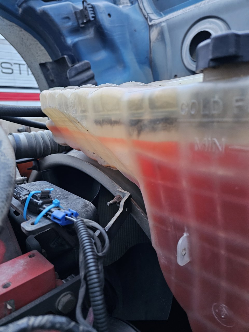

    I just posted a thread about oil in my coolant reservoir and I also have a cm2350. Did it looks like this on yours?

    Yours looks much better than mine, it is like mine coolant tank in early December 2024. Right now my coolant tank is greyish milky again....keep running until coolant consumption surge to 1 gallon/day or oil becomes milky.
