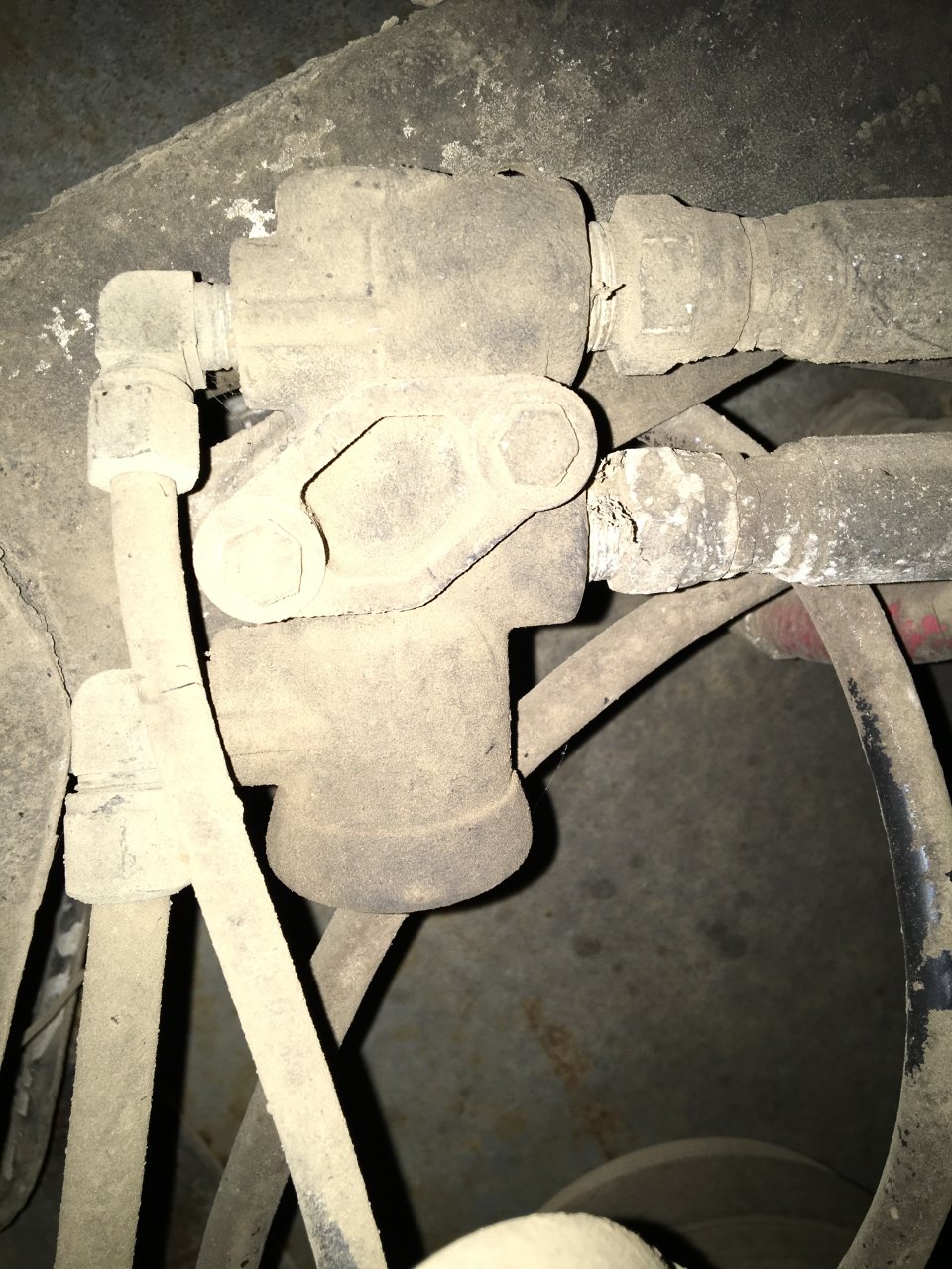

    I am in the process of getting our new to us truck ready for inspection. When doing an applied pressure brake test, I am getting air through the blue trailer line even with the trailer valve still pulled. Yellow knob is the only one pushed in. The trailer valve is a brand new valve because the old one was leaking. Is it possible we got the valve installed wrong or is something else wrong?

    The valve at far end of both em. an serv. brake lines under sleeper is bad, order protection valve

    Looks like that's the valve.
    baha Thanks this.

    Kenworth has it in stock. the parts guy said the exact same valve is used on most of their trucks even now. Must be a good design....
