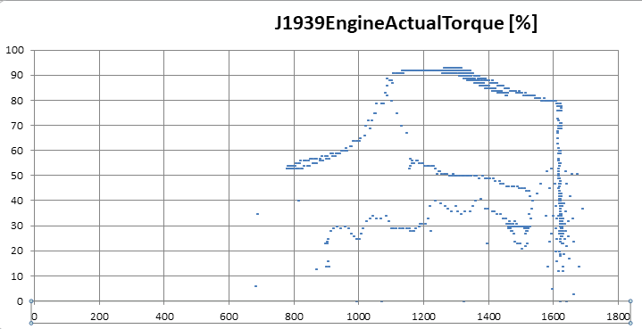

    Is yours 1850 torque?
    Your gauge most probably shows J1939 parameter Engine Actual Torque %.
    In that case it is pretty common on Cummins and Detroit (at least Series 60) engines to not go to the full 100%. I have seen it many times.
    It is all based on Engine Reference Torque (another J1939 parameter).
    In many engines Cummins set the Engine Reference Torque really high, for whatever reason. Much higher than the real maximum torque the engine develops.
    And they often use the same Engine Reference Torque value for different torque ratings, and limit Engine Actual Torque % to different levels.
    As a result, the Actual Engine Torque % may never go higher than (as an example, I don't know the exact number) 85% on an 1850 engine, mid-high 90's on a 2050 torque engine.
    From what I have seen in the J1939 CAN data for Cummins I would say it is pretty normal.
    A few examples of J1939 Actual Engine Torque % vs rpm, as I measured on dyno:
    ISB 520 lb-ft
    ISX12 425 1450 lb-ft
    ISX15 425 Smart Torque in high gear (13):
    Same engine, 11th gear :
    ISX15 EPA13 500 1850 lb-ft:

    It's an 1850. So your saying that full torque (1850) is shown at 85%? Confusing. Cummins stated the guage is calibrated for the engines rated torque. Doesn't feel like I'm getting full torque.
