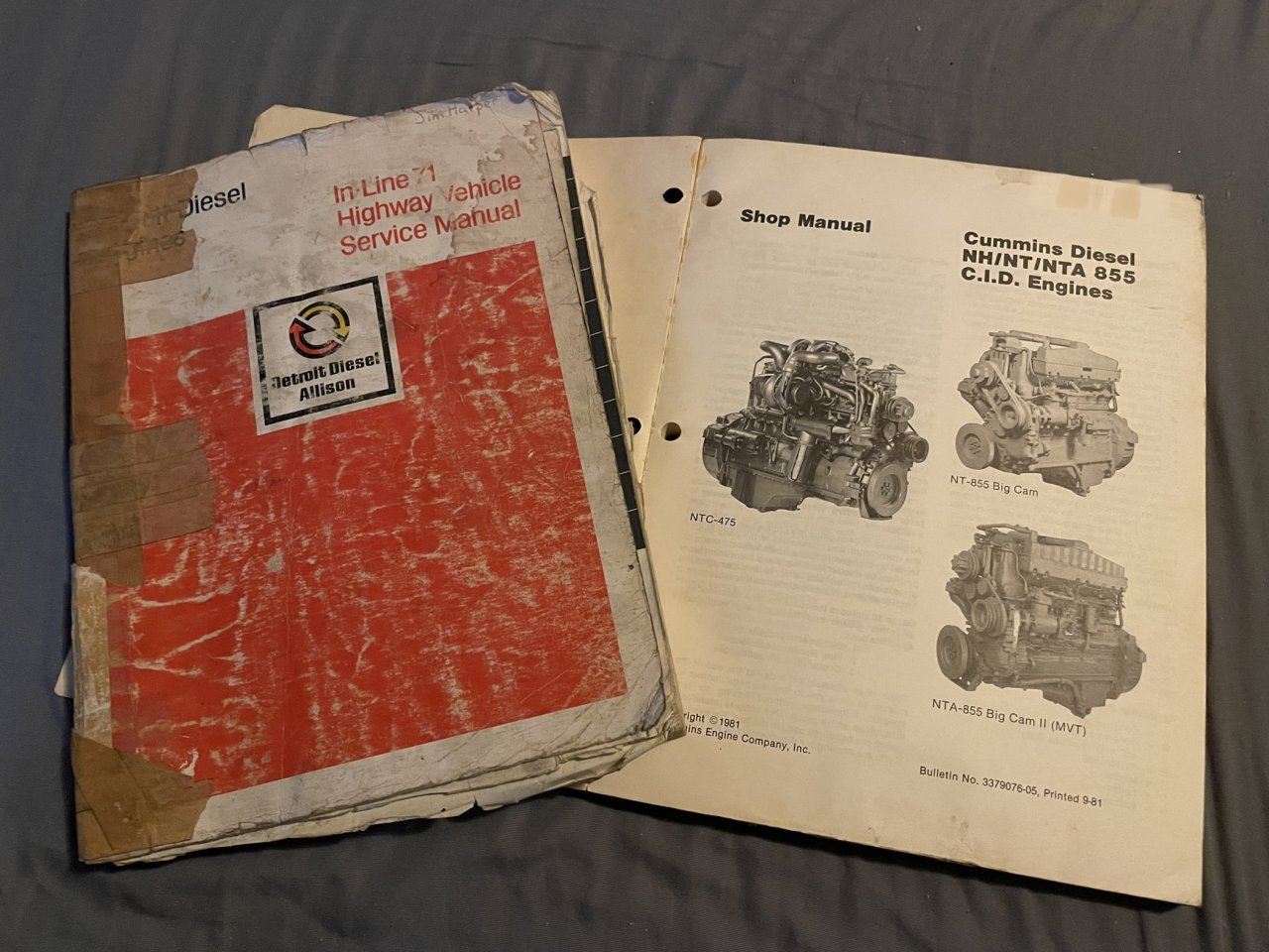

    Digging through some old boxes and ran across some old shop manuals from when I went to Ohio Diesel Tech in Cleveland. The 6-71 manual got a lot more use than the Cummins manual so it's been rebound with tape a few times. 5C3900D1-F81C-498D-A62F-316693886EC2.jpeg
