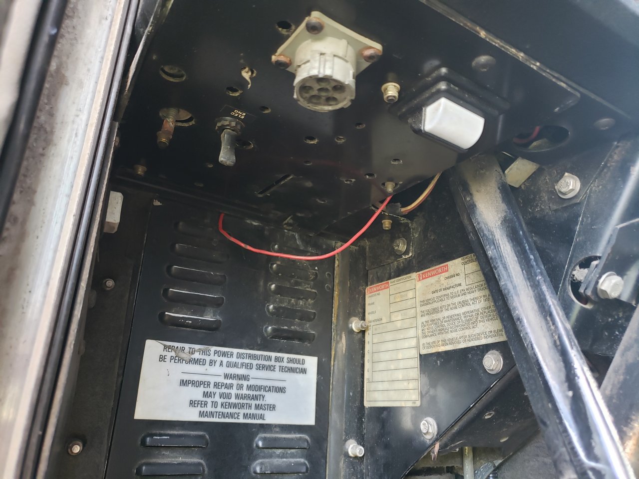

    Do anyone knows if a 92 Kenworth t800 has the ecm plug and if so where. It has a N-14

    20200827_140915.jpg Under the dash above the clutch pedal. Should be a port by the actual ecm also. If its missing I would open the dash and see if its laying in the bottom of the dash.

    Generally they’re just above the fuse panel. Is this a new to you truck ?
    The early n14 were mechanical
    If you have a hole there it is probably broken laying up in the dash space somewhere

    I had a 94 w900 and that’s where it had it but this one doesn’t I opened the panel and is not inside and no there is no hole on panel. Is not a mechanical it has a ecm with the fuel cooling behind

    Is this engine original to the truck or did someone swap in the N14 later on?
    If the truck came from factory with a mechanical engine and that N14 was put in later, the dataport plug could be anywhere. You'd have to start searching for it.

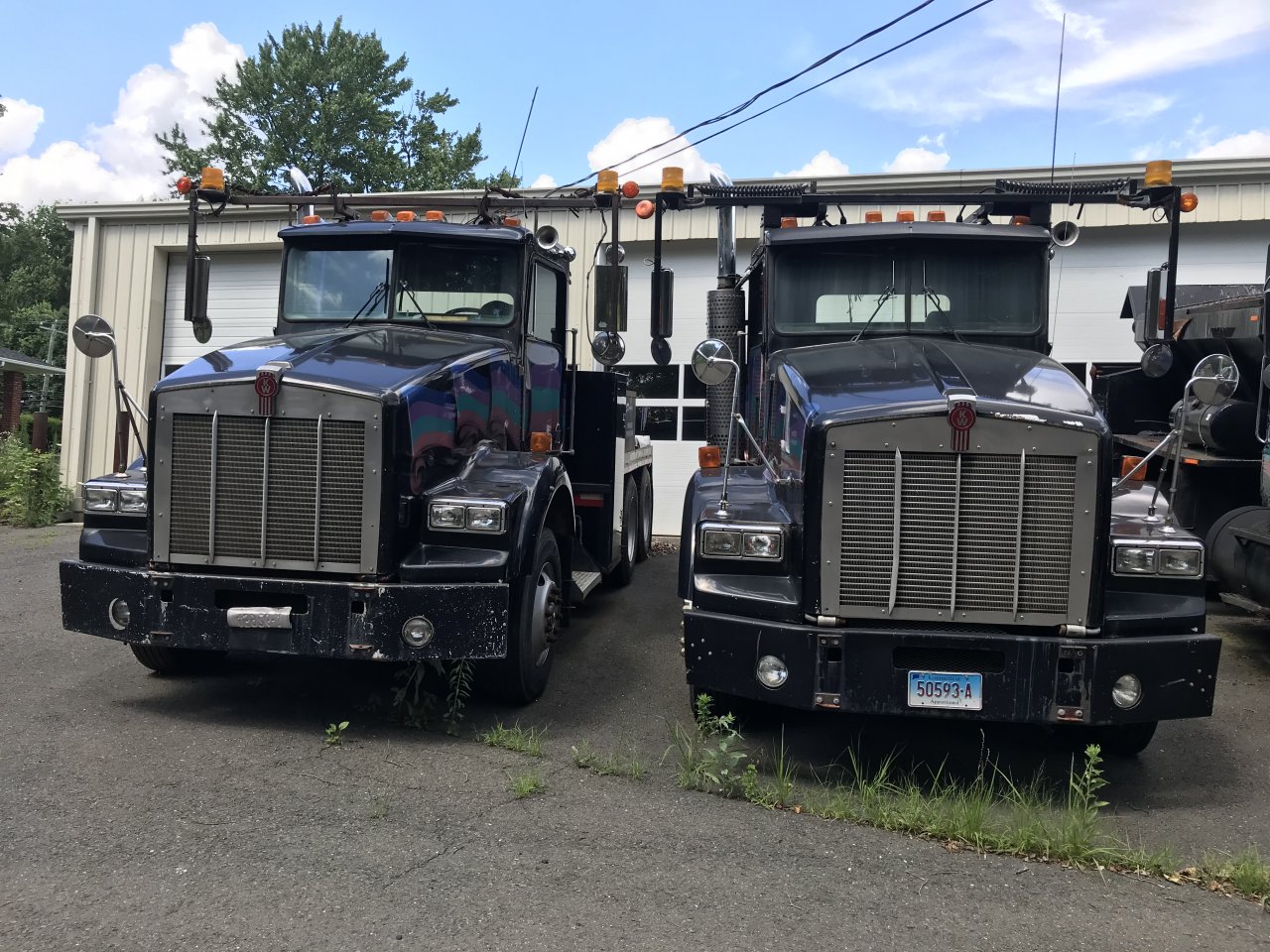

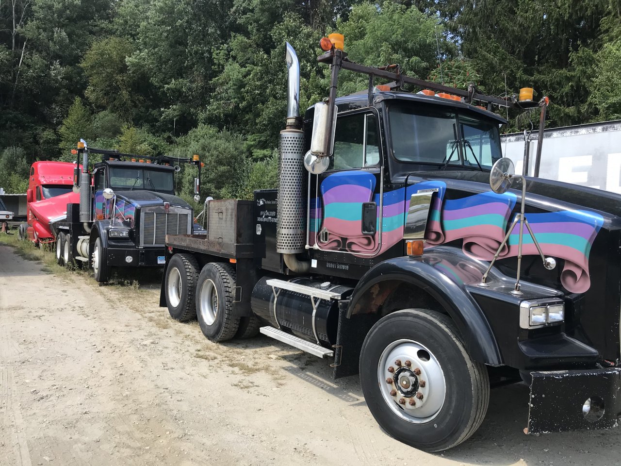

    I have 2 of them, they use to be old Cocacola trucks and they both don’t have the port. I doubt Cocacola is gonna switch it
