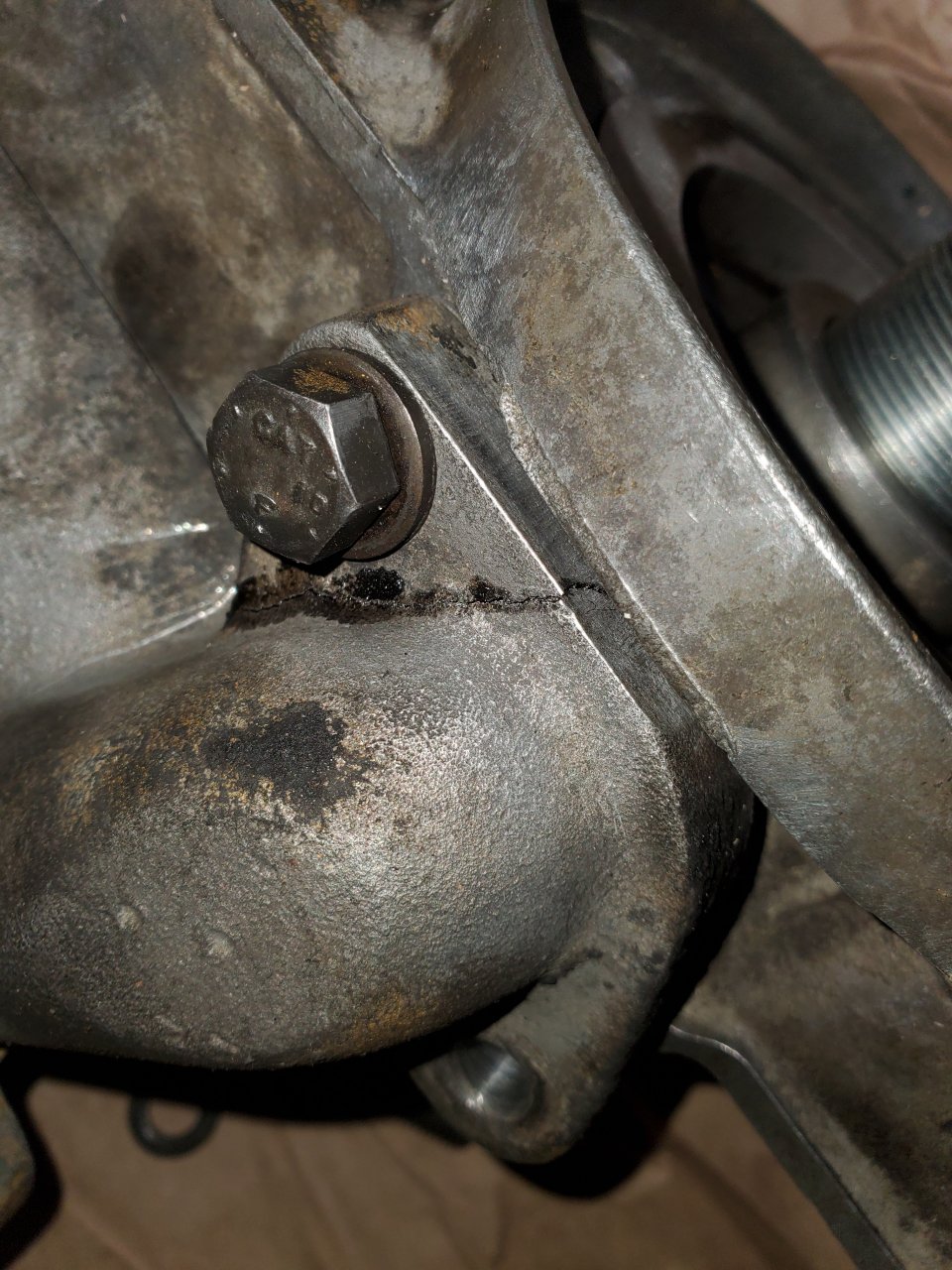

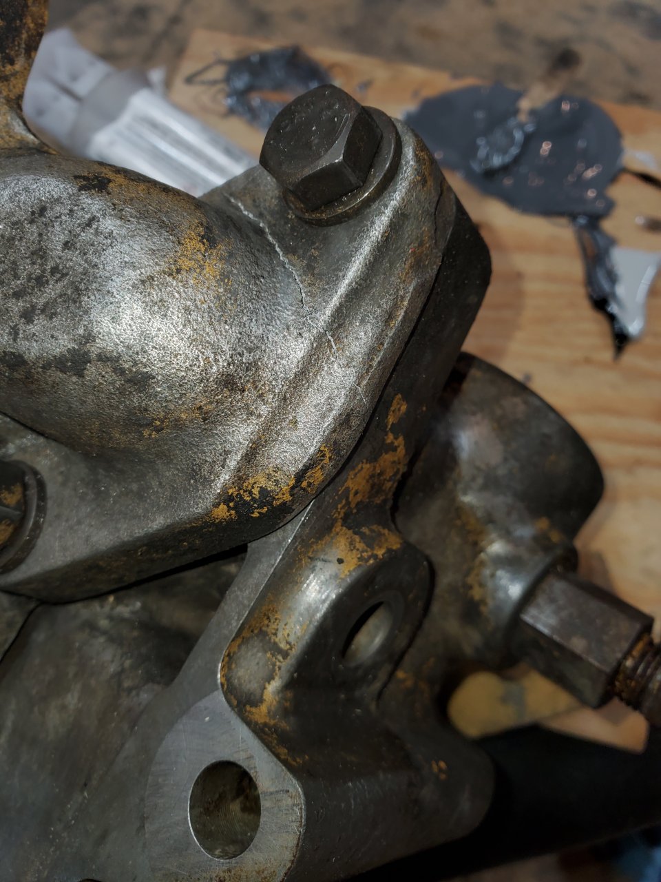

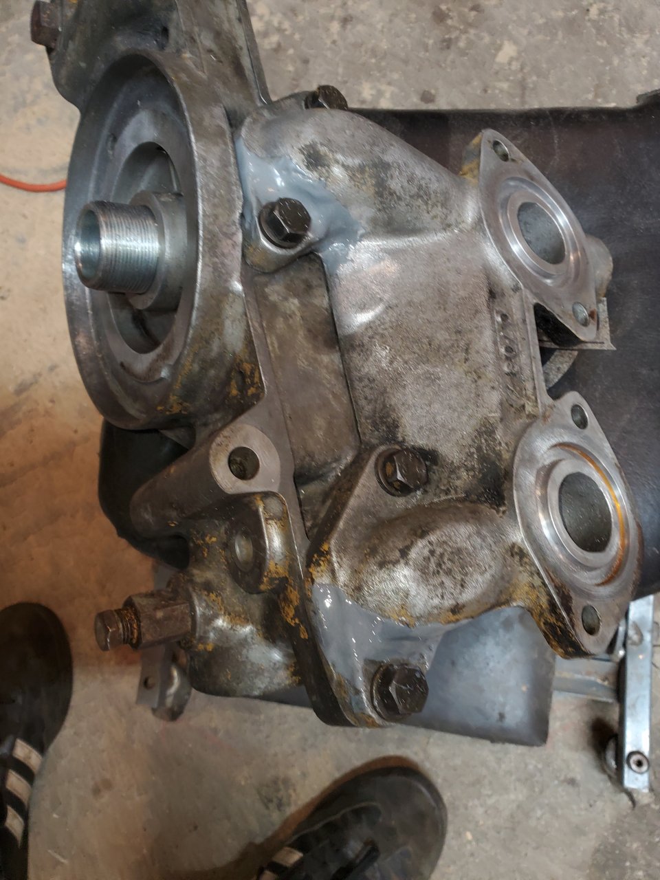

    Well, with the time i had, i decided to change my leaking oil cooler gaskets, then decided i wanted to clean the whole filter housing
    Choice 1, fine, choice 2, not so bright
    The casting between block and filter housing took easily 50 ft lb to back off the bolts, torque spec is about 15 ft lbs, upon cleaning and reassembly
    1 ear cracked, fine, remove, jb weld, ill get another housing, but it was 6 pm. I dont have high hopes for jb weld in this position, but it may see me through tomorrow.
    Inspect jb weld, reassemble, torque to 10 lbs this time, crack another ear.
    I wouldnt normally care, id get the part tomorrow and thats that, but i have a load i already put off a day thats already on my trailer.
    Jb weld 2nd ear, waiting on cure till at least not tacky so i can reassemble and fill oil/coolant.

    And nope, its dicked
    JoeyJunk, RedForeman and Rideandrepair Thank this.
  9. skallagrime
    skallagrime Road Train Member
    3,855
    9,929
    Apr 10, 2012
    Indiana
    Interesting, new part has a groove set up so that it WHEN the oil seal fails, it will show up at a predetermined failure point (the notch). Or at least thats the hope.
