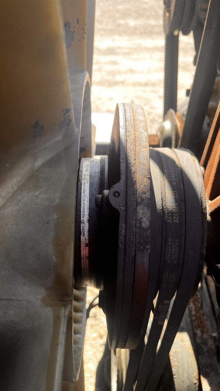

    Okay so I confirmed the lines are proper to and from the solenoid. I also discovered that I believe it needs air to turn on the fan? Or at least when I turn my manual fan switch on, and when the truck is OFF, air flows out of the solenoid to the fan. When the truck is in accessory the air to the fan turns off. But the fan is getting air but still stuck on. When I plug the solenoid in and out, I can see the clutch/hub move just barely. Like maybe 1/32” movement. So that tells me it does seem to be moving and getting air, but not enough? Shop air directly to it does the same thing - moves it in and out very slightly but fan still stuck on.
    I have soaked it in PB blast and tapped it with a hammer some more. Still nothing.
    Here is where I see it move. The ring to the right of the Horton label.

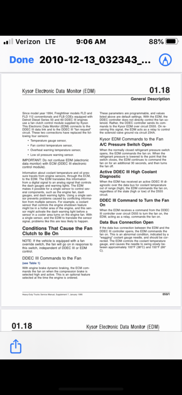

    4D4CD6E8-CED5-4326-AF2F-AFB234E9CDDE.png Though I’d add this. Just came across it. Might help someone else someday.
    Jed2009 Thanks this.
