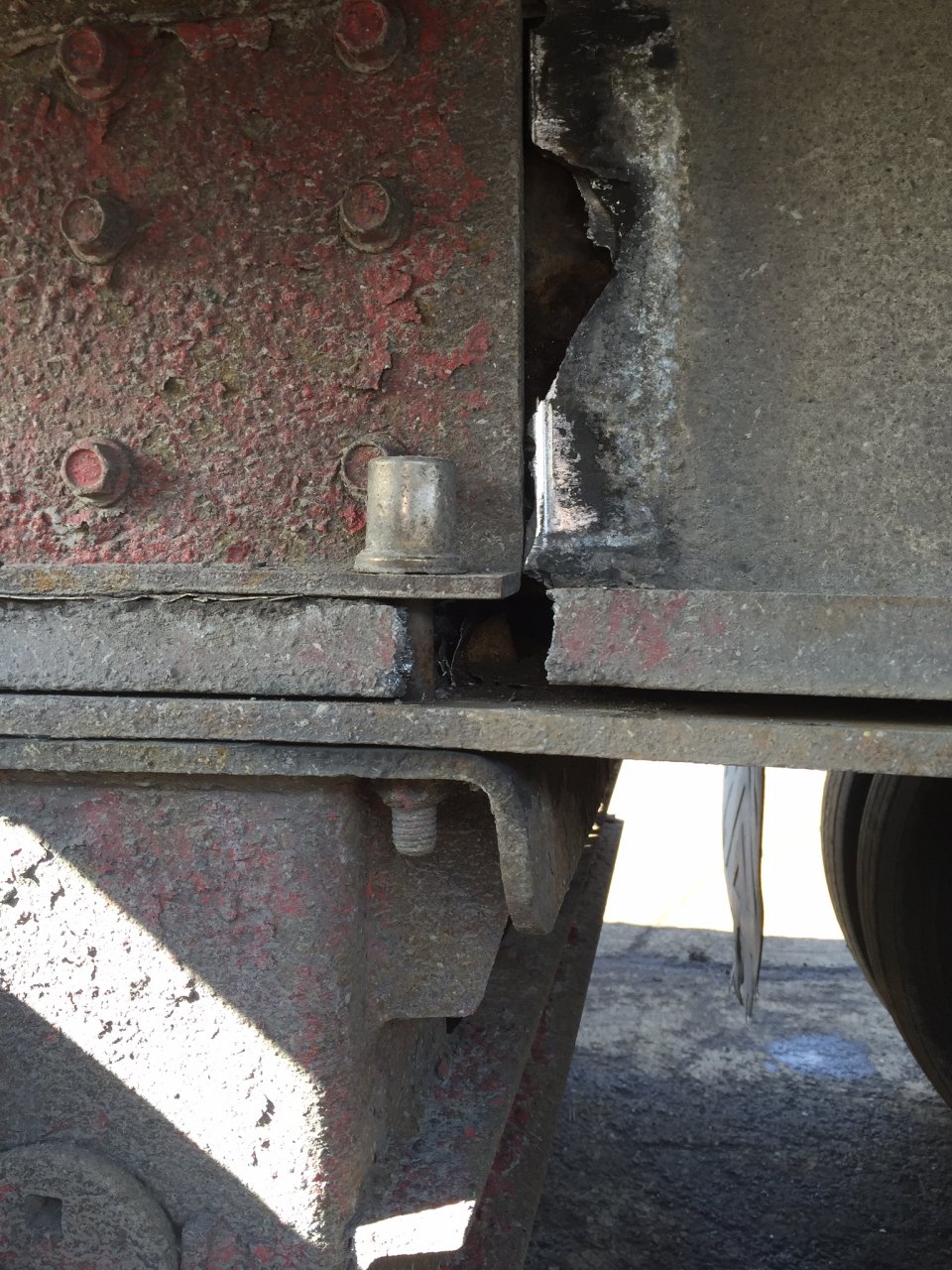

  8. kranky1
    kranky1 Road Train Member
    2,253
    8,854
    Sep 16, 2015
    Ontario, Canada
    beastr123, CAXPT and Ruthless Thank this.
