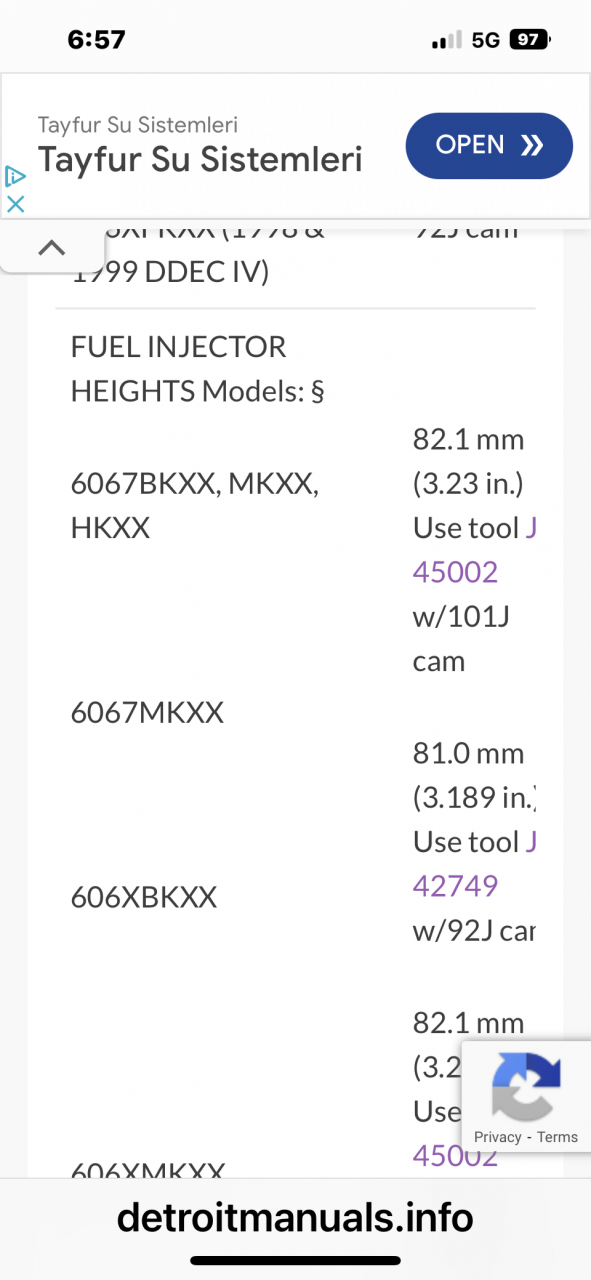

    Can someone tell me if this is the right tool for the following engine? 1998 Detroit Diesel series 60 12.7
    06RE138333/6067BK60?
  3. Big Road Skateboard
    6,178
    33,896
    May 2, 2021
    Could be. 81mm is very common, but 80.3mm was too.
    Are your ID tags missing from your valve cover? If not, injector height is listed there
    W923 and Rideandrepair Thank this.

    the right tool is based off the number on the back of the cam who knows what cam may be in it
  7. little cat 500
    little cat 500 Road Train Member
    2,051
    1,097
    Jan 17, 2010
    Abbottstown PA
    guess i should have said its based on the cam number not the year of the truck used truck could have many different cams in it
