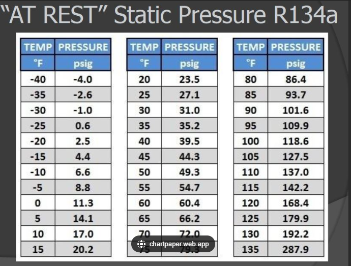

    Is there a sight glass in the receiver drier (filter can)? Did you buy brand name parts such as Sanden compressor and match them to the old ones before installing? There is a lot of cheap imitation junk out there. Did you use cans or a cylinder/tank to charge? Did you bleed the air out of the hose? Air in the system can cause high discharge pressures. Orifice tube goes with an accumulator system while expansion valve goes with receiver drier.
    Static pressure should be in the high nineties, about 97 psig. Low static pressure could indicate an undercharge. I would have someone recover the refrigerant now in there and charge by weight and see where things end up.

    So I did use sanden compressor used cans and also bled as I replaced cans. The drier does not have sight glass. The static pressure is right. Another question So what does high and low pressure suppose to do when the fan kicks on?

    Post #6 - "this is pressure with truck off" Your gauges read about 52psig. Chart shows high 90's. Your barely over half of what the reading should be. You said outside temp was 87 F. Look at pressure on chart.
    In post #13 you state "The static pressure is right." How is the static pressure (truck not running) right????
