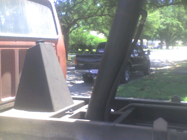

    I will make a habit to remove from PTO as soon as the load drops. As far as the hydraulic tank. I cant say for sure but I believe I found it with a fill cap on top of the pyramid.
    Pictures attached below.

    That looks like a hydraulic tank....right where I said you might find it. You do want to be careful not to OVERFILL it....remember, as the hoist raises the bed, the oil level in the tank is going to drop...so when you "top off" the tank, you have to leave enough room for the oil that is in the hoist to go back into the tank. If you don't, it'll come out the top through the vents and HOPEFULLY not damage anything.
    Also, any time you are under there working with the bed raised, make sure you block the bed so that it cannot lower on you.

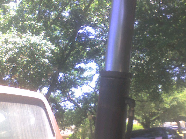

    Luckily enough today I found 2 places that will do the mechanic end of it and also repair the hydraulic system. I still need to determine if it is the line or the ram that is leaking oil but it will be a two people job and I'm waiting in a buddy to come work the control while I look. This issue may be as simple as the line going to the Ram leaking or it could be the seal at the top where the cylinder comes out leaking. It seems as if it is spewing a little hydraulic fluid when the bed is lowered and then it stops spewing drips then stops leaking all together. The control vavle is certainly leaking where I mentioned before. So if it is a matter of just the line and the control vavle I will keep the bed lowered and pull it myself bring it to have it repaired and then put it back in. If it is the Ram then I my have them do the entire repair.
    One said they couldnt give a price without looking at it. The other said they couldnt tell me the price on repacking the ram but generally the labor to pull it out and put it back in runs about 400.00 plus whatever the parts and cost to fix the ram itself.
    So I'm not overly scared even if it is the worse case scenario with the Ram but hoping its the line that goes to it.

    Ok from what I can tell the cylinder ram has three parts when extended all the way up. The case then there is the first cylinder (larger cylinder) and then one that comes out of that one that fits inside the larger cylinder that is the small cylinder that mounts to the dump bed itself.
    When the cylinder is raised to elevate the dump bed it leaks at the top of the small cylinder where it mounts to the bed. When the bed is lowered it drips for abut an hour then stops. I guess my first question is what seal is at the top like that that would leak fluid? Next could the system be overfilled? I remember a few days ago the leak was worse and seemed to spew fluid as if it was under pressure and coming out. Today it was more of a steady stream when the bed was elevated and as I said slowed to a drip then stopped once the bed is lowered.
