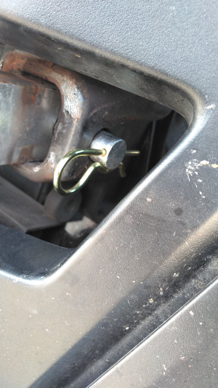

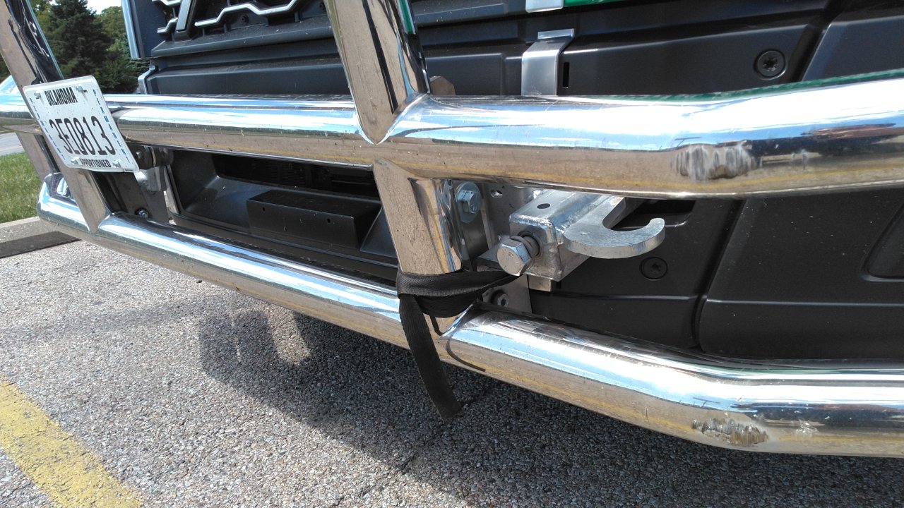

    One end of the deer guard fell off while driving down the interstate. Made an awful noise. I pulled over and strapped it to the plastic to keep it off the road. Luckily, I was bobtail, so I found a Tractor Supply nearby.

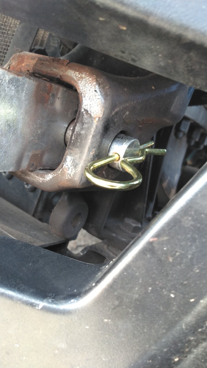

    I found the 3/4" pin that fell out, and bought a new hitch pin to retain it. Check your hitch pins, they should look like this. KIMG0628.JPG
    Not like this, or some other way...
    The one on the other side was installed wrong also.
    You should install it like the lower pic, then push it over sideways so it looks like the upper pic, then it will stay in place.
    Damage from dragging on the road.

    UAW quality control at its finest. The amount of overlooked poor workmanship out of Dublin Va is mind boggling.
