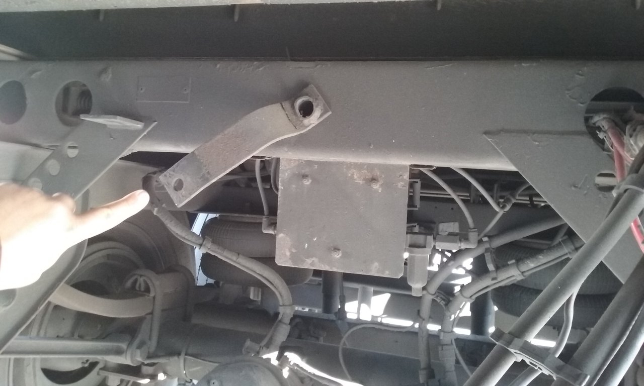

    So the tandem pins would not release on my 5100 series wabash reefer. It has a small silver easy to push pull knob, not the black spring loaded one. Turns out this trailer has a manual pin retraction that is air actuated. It was sticking today. Give it a LIGHT push to driver side and it retracts. Just dont be in its way!

    Take your hammer, and smack that bar so it swings towards the drivers side. That will in turn, pull the pins in
    JohnBoy and MidWest_MacDaddy Thank this.

    And yes you did it correctly. We have many trailers like that. Usually all of them have the red button. All others have the black button.

    Some have the manual pull handle.

    True, but they're getting rid of all those. I only know cause for about 2 weeks straight I only ran the new trailers back to the terminal and the old ones (pull handle style) out. But yes you're correct
