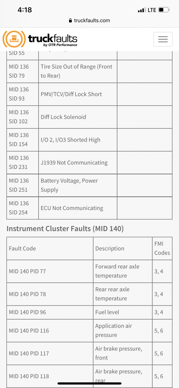

    Same just happened to mine while parked. I do have a code on my dash that i dunno if anyone could interpret. 136:F14 SID254_A

    Eldoradoexpress Thanks this.
