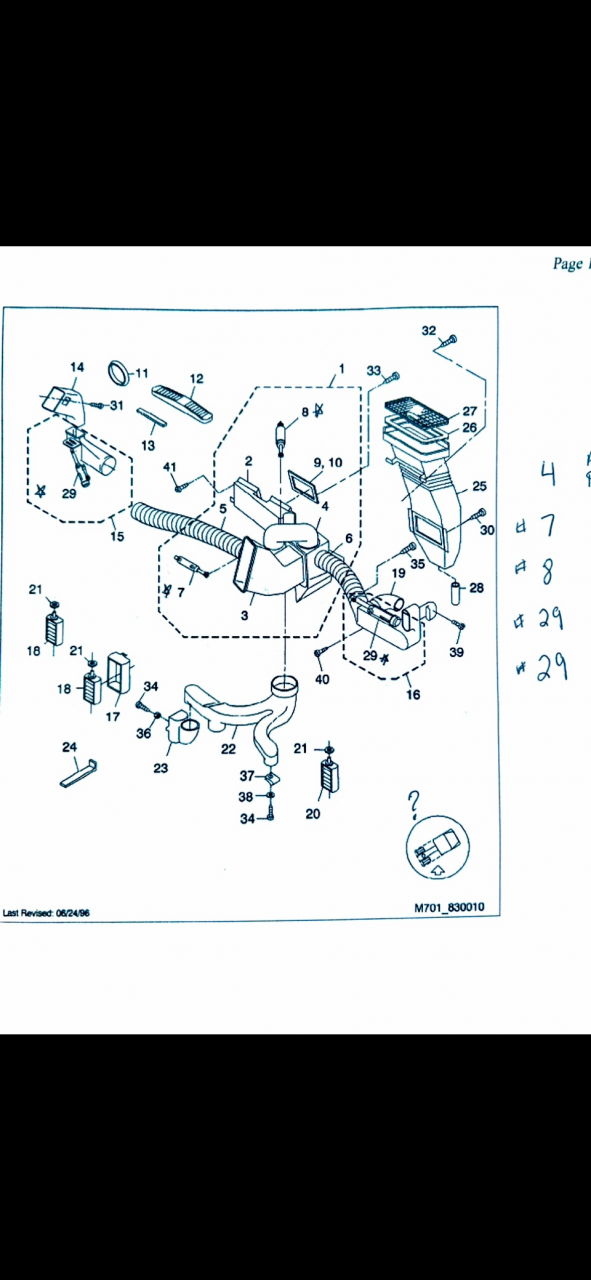

  9. Rideandrepair
    17,356
    56,314
    Aug 8, 2015
    There’s 4 pistons total. #7, #8, and 2 ea. # 29’s. They only control air direction. # 8 controls vent/heat # 29 on passenger side closes recirculating door when set on max a/c. # 7 controls heat/defrost vents. I guess # 7 could technically be considered a blend door control because it sets full heat vents, or a blend of heat/defrost vents, or full defrost. Drivers # 29 controls little useless dash vent near door. Only the water valve controls temp. Unless it was changed after 2000-2002. Maybe. I’d say if you have a manual cable operated temp valve, this diagram is accurate.Same system as my 2000.

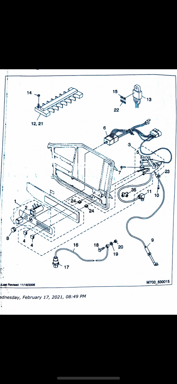

  10. Rideandrepair
    17,356
    56,314
    Aug 8, 2015
    9E686417-F916-4137-895A-AA29F0E8537C.png This shows the manual cable for temp valve. # 9
