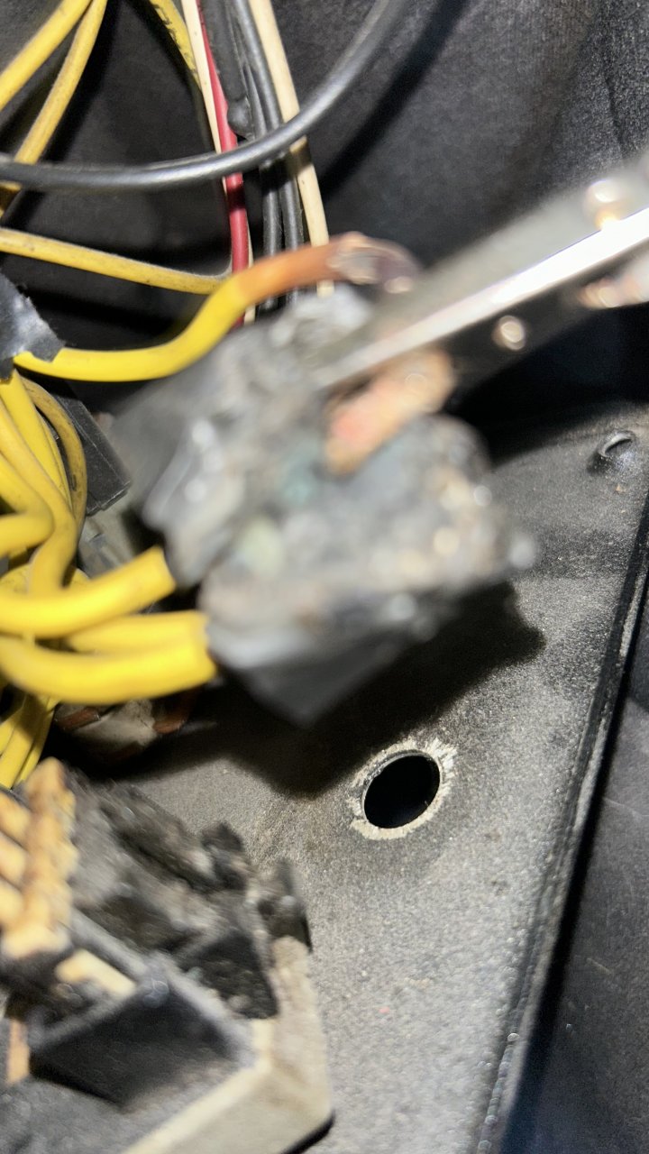

    ACC59CF6-DF45-437F-B955-C8D98067BD09.jpeg Here’s my bunk switch plug. It’s melted. Just bought it ( short harness) couple years ago. I’m not buying another. Got new ends for the wires, attach them one at a time. Did that on my last one. It must be caused by the switch terminals getting loose. Cheap switches. I have mine running constantly now, attached burned wire to burned plug terminal with alligator clip. Doesn’t get hot at all.
    aceman18 Thanks this.
