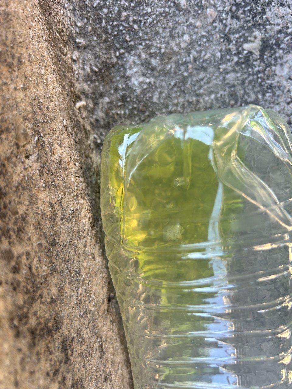

    I’m currently draining the Freon out and the oil looks clean so far.

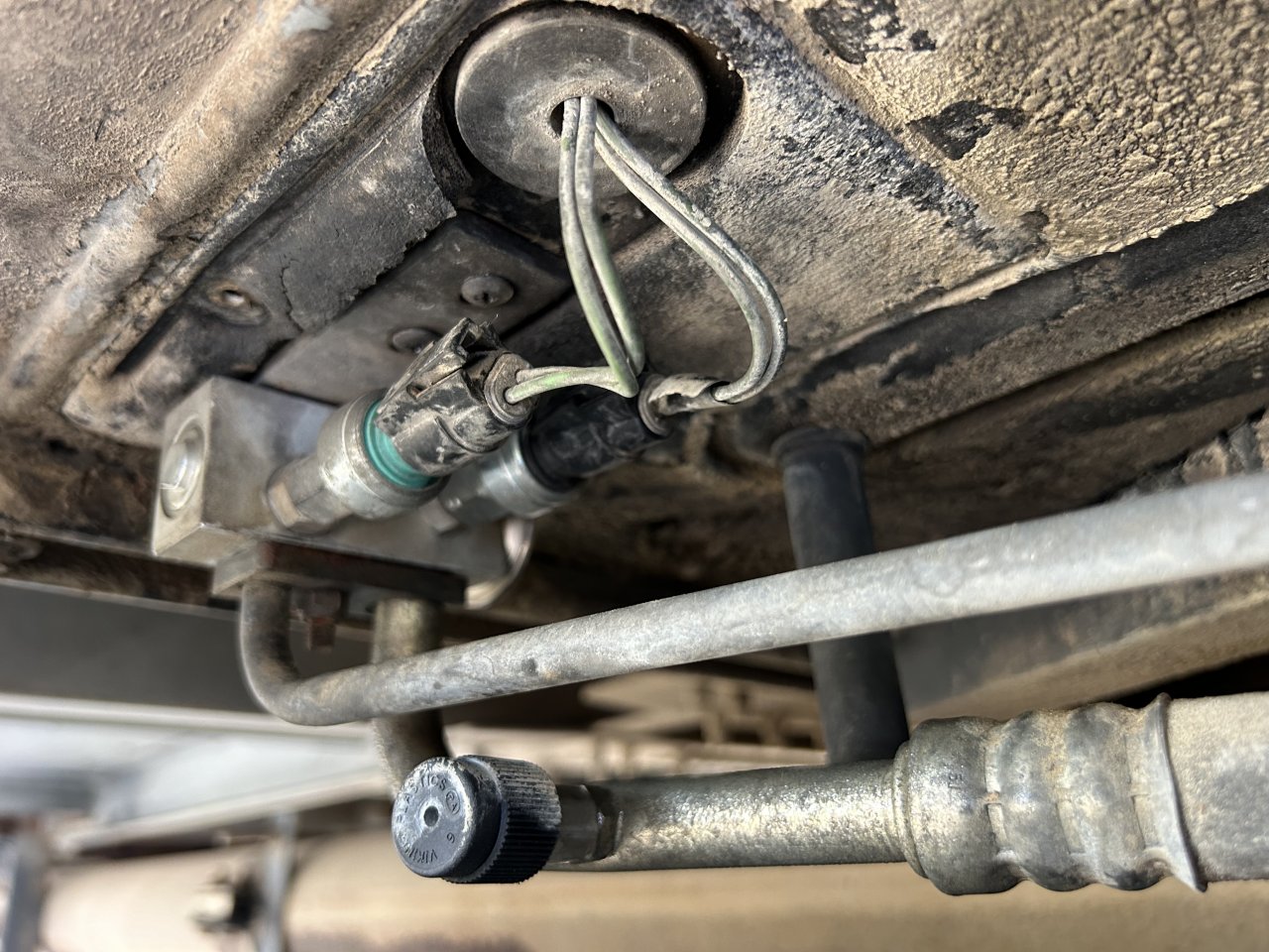

    Got everything cleaned up,system vacuumed,and charged up. I do have doubts about the wiring that goes to the sensors on the expansion valve. I didn’t take pictures and now wondering if the right plugs are hooked up to the correct sensor @Heavyd .
    Truck is a 2003 International 9900I with Sanden compressor.

    The Low pressure switch should have wires 77P and 77E going to it. High pressure switch will have 77N and 77J.
