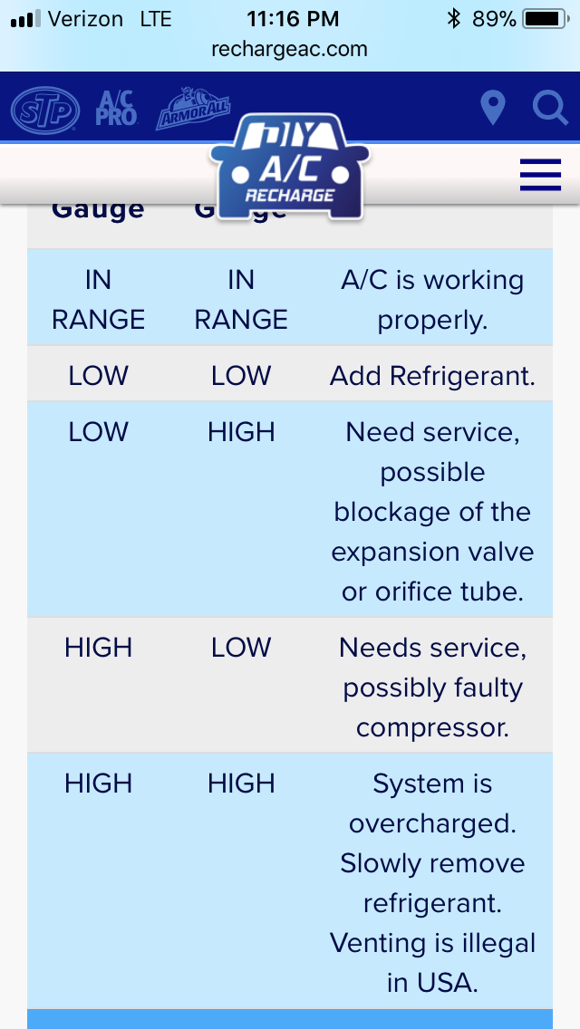

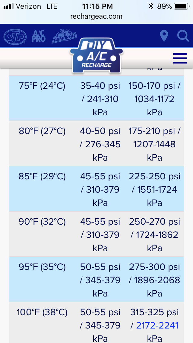

    F56651D3-46D5-49E3-917E-00CBE1A96308.png 4413AB6E-C190-4983-95B5-FD5DBAD2C6FD.png
    this is 134A charts. dont thank a fully charge system will show 110 on both sides js.
    Rideandrepair Thanks this.

    and just for the record. 134A goes only by outside air temp. like i said at the end of the day. gauges will be needed to check the system. pressure switch wont engage the correct way if the pressure isnt right.

    You missed the part of the post. EQUALIZED ON BOTH SIDES. That means no compressor.
    What you posted is a chart of operation pressures. That means compressor.
    And I'll let you in on a little secret.
    I have that chart. And it's not accurate. Not for cars. And certainly not for trucks.
