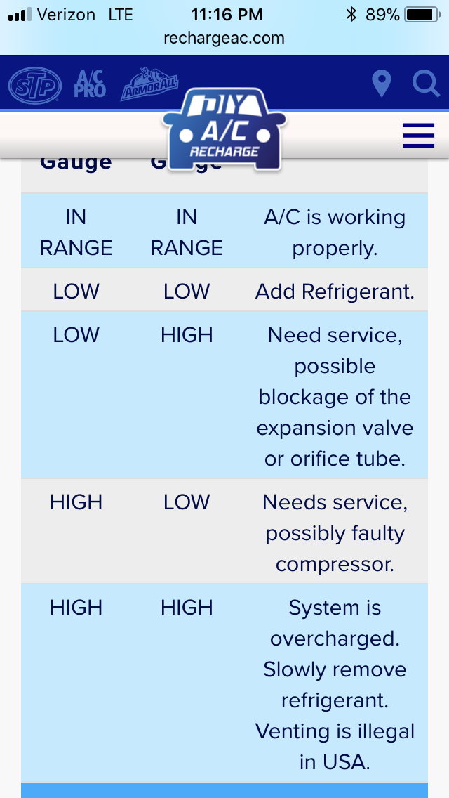

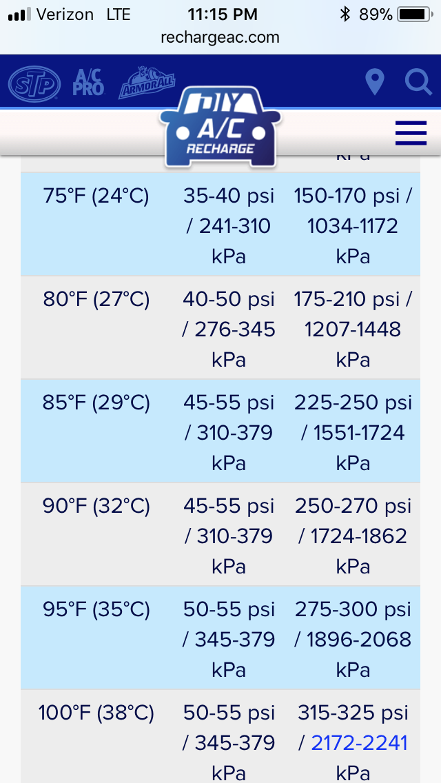

    put gauges on it. dont waste anymore time or money.
    spsauerland Thanks this.
  7. truckdriver31
    6,989
    8,352
    Sep 18, 2013
  8. truckdriver31
    6,989
    8,352
    Sep 18, 2013
    these charts are for 134a. you charge 134a using only the outside air temp. like others said bad orifice tube or expansion valve. also check cab filter and evap. could be dirty evap
  9. truckdriver31
    6,989
    8,352
    Sep 18, 2013
    did he break the system. if so then more then likely the dryer/receiver has filled up with humidity and causes beads to come out. in that case expanson or orifice is clogged. you also change dryer/receiver when you break system.
