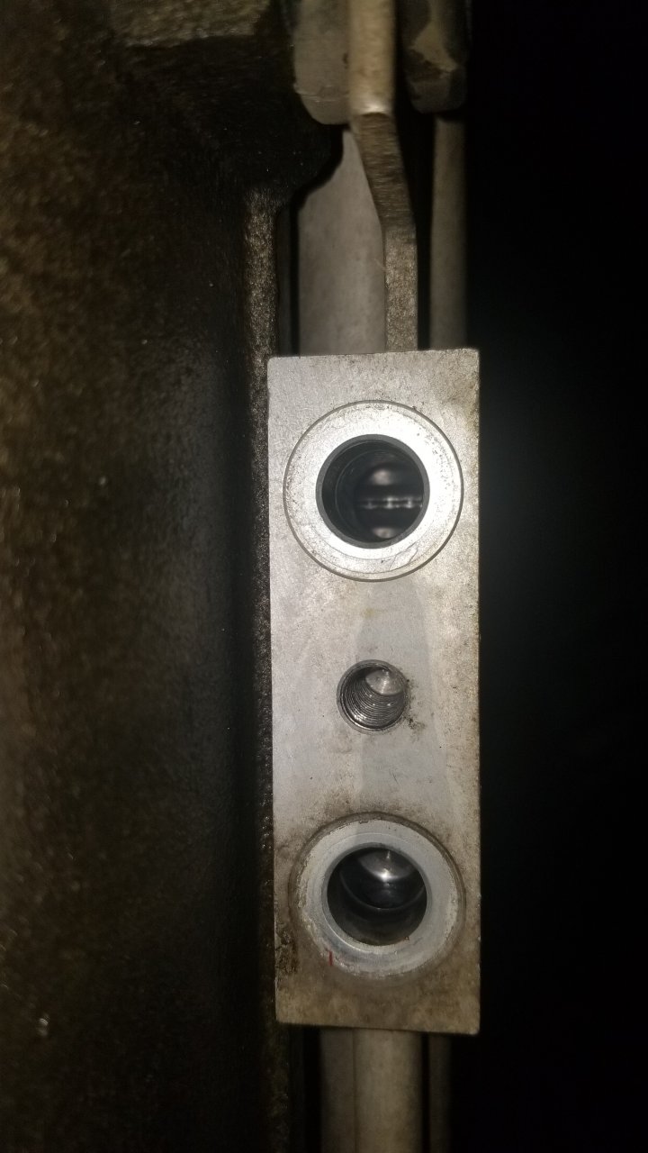

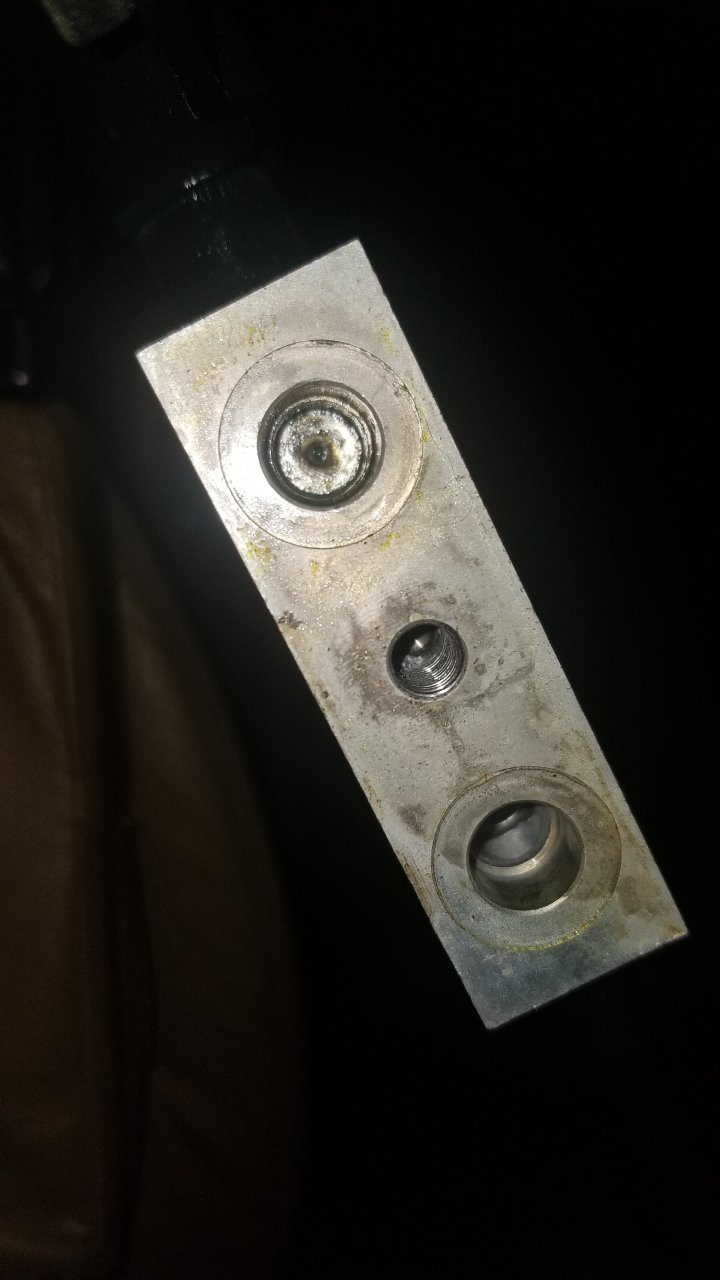

    The problem is, on the new condenser from those Michigan people... the intake hole, where the freon line comes in, well, it's not a hole.
    I mean literally, it doesn't go anywhere. They didn't drill it all the way through. Here is what it looks like: 20190425_234917.jpg
    And here is what it's supposed to look like (from the old condenser): 20190425_235206.jpg
    Sorry about the bad quality, it is night time and I am tired. On the old one, it goes through to the interior of the condenser.
    So there you have it. If these people blew up my compressor with their un-holey part, they are SO paying for all the repairs. What a day. I guess that's what I get for trying to save money. If you ever buy stuff from these clowns, make sure that the holes actually go places.

    Good God, that’s terrible, sorry to hear all that. No hole at all? How in the hell? It even looks chewed up.My apologies for the bad reference

    Almost looks like metal from a bad compressor clogged it up.

    I thought about that, but honestly it looks too solid and seamless. Like it's a part of the inlet outlet aluminum piece, not anything separate.
