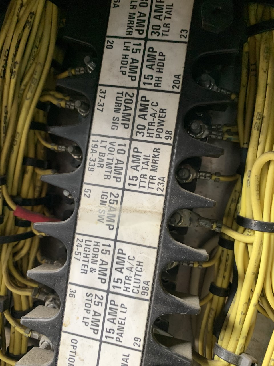

    Hey folks,
    Rookie question. How do you check and remove these circuits on a 96 FLD? I unscrewed the nut but nothing seemed to want to move and I don’t want to bust anything.

    I think to get to the whole circuit breaker you have to take that centerpiece off that has all the markings for which breaker is which.

    The plastic just a cover for the breakers. No need to take it off to test with a test light. Like Dino said, I’d try jumping the pressure switch. Unplug it from dryer, jump the plug. See if it turns on. If so, low side of switch is bad. Replace switch. The other switch on drier with pigtail is fan switch. Pressure switch doesn’t have pigtail. You can change switch without losing any Freon. I think there’s a constant power wire running from starter maybe? Cant remember. Follow the 2 wires from compressor, inspect for chafed/broken wires. I’d leave the fuse box alone. Unless necessary. I had one 3 prong breaker on my last Truck that the plug went bad. I had to twist one of the prongs and plug it in. It worked, Lol. Considering I’ve heard a lot of problems with Freightliner wiring, and haven had hardly any problems. I’d leave it alone. It’s a can of worms.

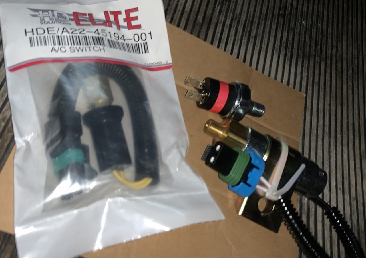

    These are the switches and sensors I ended up with. I think two are the ones you were talking about @Rideandrepair They can both be replaced without fear of Freon blasting out or anything?
    Rideandrepair Thanks this.
  8. Big Road Skateboard
    6,305
    34,953
    May 2, 2021
    Yes.
    Rideandrepair and Jed2009 Thank this.
