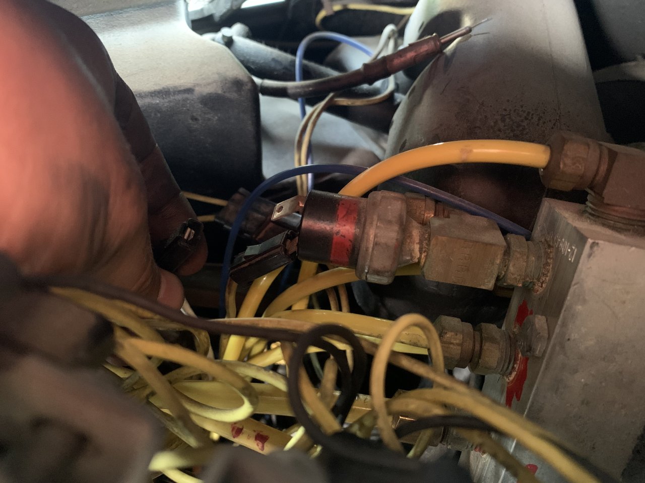

    7FDB4526-8C65-4B1E-A075-4B8AE2E12527.png You can test the low pressure by jumping the plug with a paper clip. If it’s bad, jumping it will make the compressor engage. It’s to protect the compressor from running when Freon leaks out. Some people jump them when filling an empty system to speed things up. Bad practice. Best to put one can, 2 if needed to activate compressor when charging. It takes longer, but avoids damaging compressor. This is the switch I’m talking about. I still forget and get them confused. Lol. This one definitely controls low pressure, and high pressure, so running it too long jumped may blow a hose, if the high side of the switch is also bad. Pretty sure other one with pigtail is fan only. I think that’s how it works.

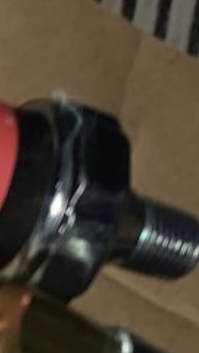

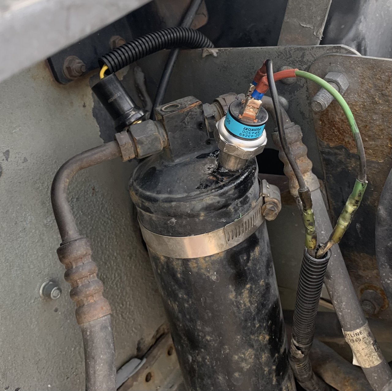

    Alright update! I started off replacing the fan switch because the “low high” switch was not correct fit for the dryer. Didn’t help. Tried jumping plug for compressor. Nothing. Rewired a questionable butt connection from compressor sensor to dryer switch. Nothing. Went to swap the part that didn’t fit for the proper part that fits the dryer (“binary pressure switch”). Nothing.
    One last hunch. A month ago I had my park brake knob valve replaced so they removed dash panel. I thought maybe somehow something back there is loose and it has to do with the AC. Remove panel and boom… the part that didn’t fit the dryer, was sitting back there with a wire unplugged. Posted a pic. Plugged it in and the compressor turns on!!
