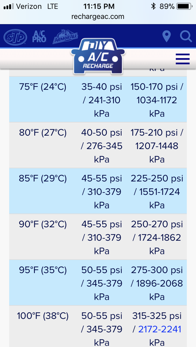

    A7AB94AF-015E-426E-BCDD-560C038AD81F.png 1B992422-06CB-43BA-8B63-1AFDA5A500C8.png
    dont guess it. put some gauges on it.

    @MACK E-6 ... Those numbers are industry standard guidelines.
    Keep in mind, A/C is not exact science due to a whole bunch of variables i.e. ambient temp, humidity, air pressure etc.
    Think weather prediction. Not exact, but directionally predictable.

    134a. 134a is the same for anything using it. the bottom chart is the measurements. the top chart you use to help diagnose the problem.
