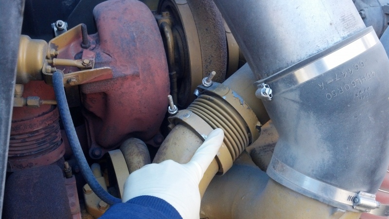

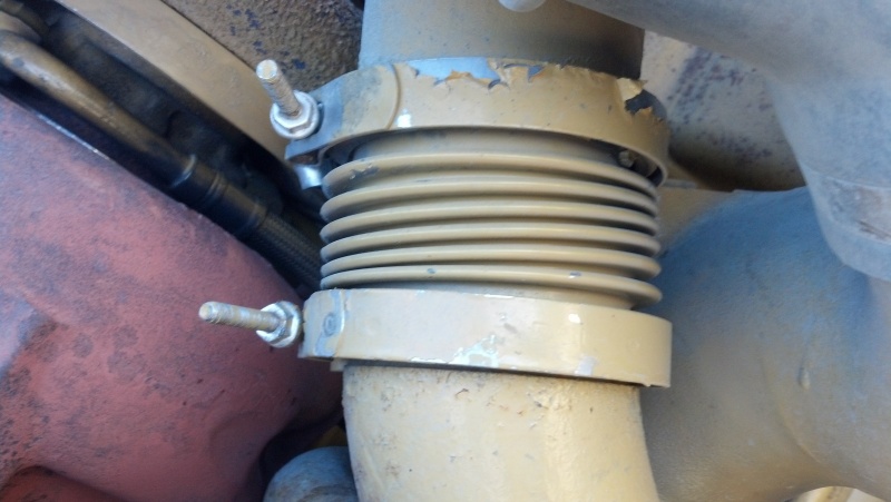

    Oscar I have an audible (under load) leak on the compression side that has me pulling out what is left of my hair. I am getting ready to replace the radiator and CAC, it needs a radiator for sure, but everyone that tests my CAC says its "within spec". I am assuming the CAC is original (everything else has been, 1,080,000 miles).
    Anyway, is this the one you are talking about?
    If it is, I don't think a boot will take the heat without some kind of heat shield.
    I can't see any cracks in mine, but that doesn't mean it's not.
    The reason I ask is mine is not even close to being straight, just kinda looks like it would leak. I know I need to replace the upper clamp, someone over tightened it and the little loops on the "T" bolt are spread way out and just barely hanging on. When I replace the clamp I'm going to try and straighten it out a little. Any other ideas where to look?

  8. bubbanbrenda

  9. bstromback2002
    bstromback2002 Light Load Member
    133
    24
    May 12, 2012
    wi
    Mine looks the same as that also bubba and it still has the factory yellow paint on it and it don't leek. I wouldn't try to straighten it you might do more harm than good.
  10. bstromback2002
    133
    24
    May 12, 2012
    wi
    Also there is another bellow behind that that goes from the top turbo straight down to the per cooler is it leaking back there??
  11. Oscar the KW
    Oscar the KW Going Tarpless
    12,246
    28,114
    May 19, 2011
    Yep, that's the one I am having trouble with. I can't believe that yours is not cracked, it is severely out of alignment. Are you sure that it is not leaking on the backside?
