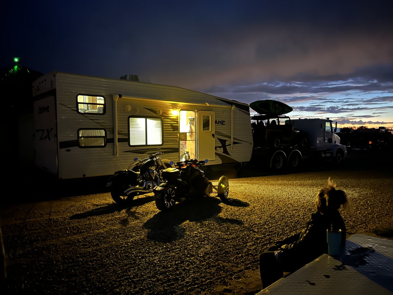

  7. Tug Toy
    Tug Toy Road Train Member
    7,067
    73,952
    Jul 4, 2015
    Corn field
    Trailer is a toy hauler so the road bikes come along back there. IMG_9650.jpeg

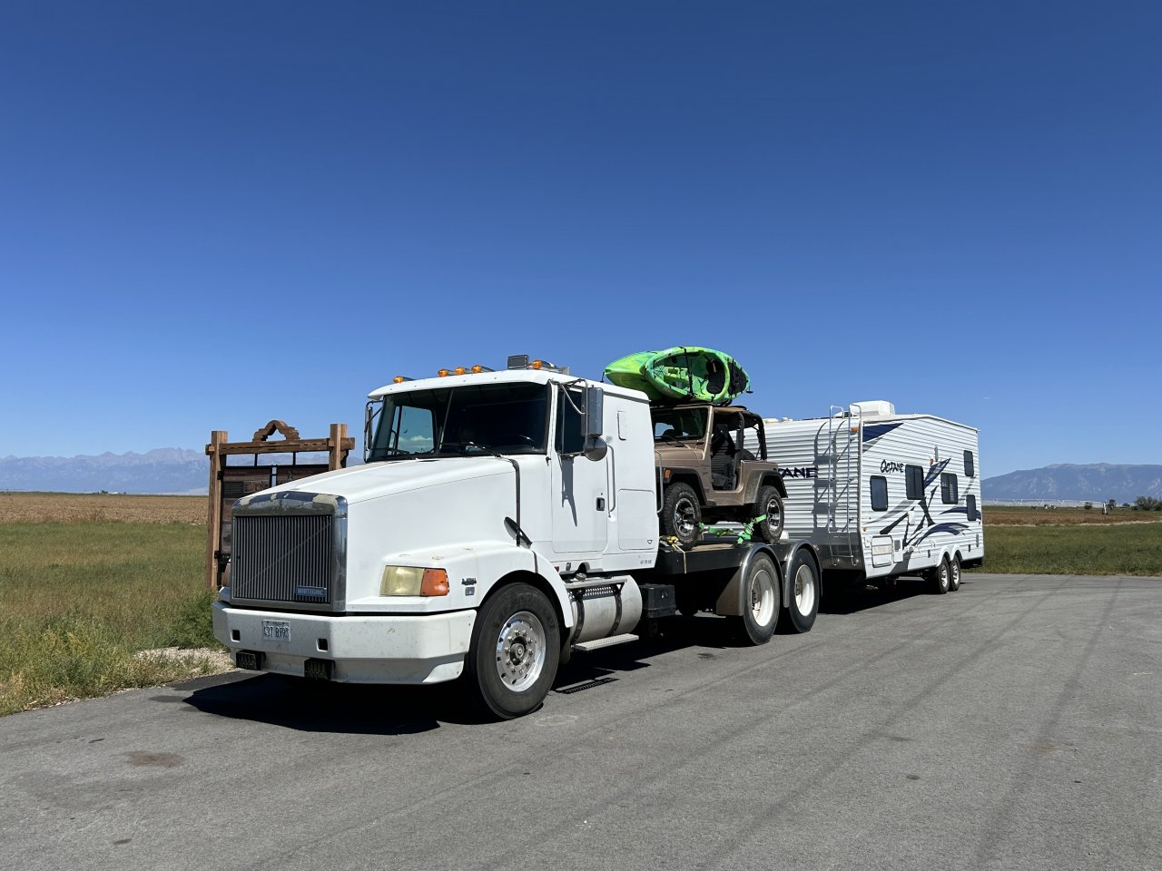

  11. 86scotty
    86scotty Road Train Member
    4,702
    12,911
    Aug 27, 2017
    Appalachia
    Tell me about the mods to the tractor to put your Jeep on it. Can you post better pics of it?
    If I could figure out a setup where I could pop our Jeep on the back of my tractor just for vacations I'd do it in a heartbeat. I've always studied the Clayton Homes trucks around here that have a ramp on the back and they piggyback their chase trucks back to HQ at the end of a haul. I'd love something like that that bolts on to my tractor just for personal trips. I've also thought about just buying an old pup trailer (28'?) but that's too involved and I couldn't take it in any CG's or National Parks, etc.
