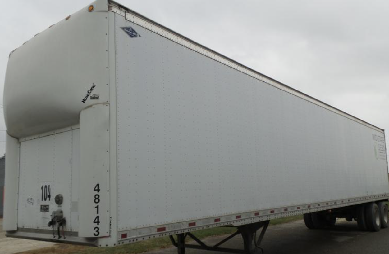

    As for the nose cones I tried to get it done to my trailer and was not able to do it. They are literally impossible to buy and install. I called every trailer place in 5 states.

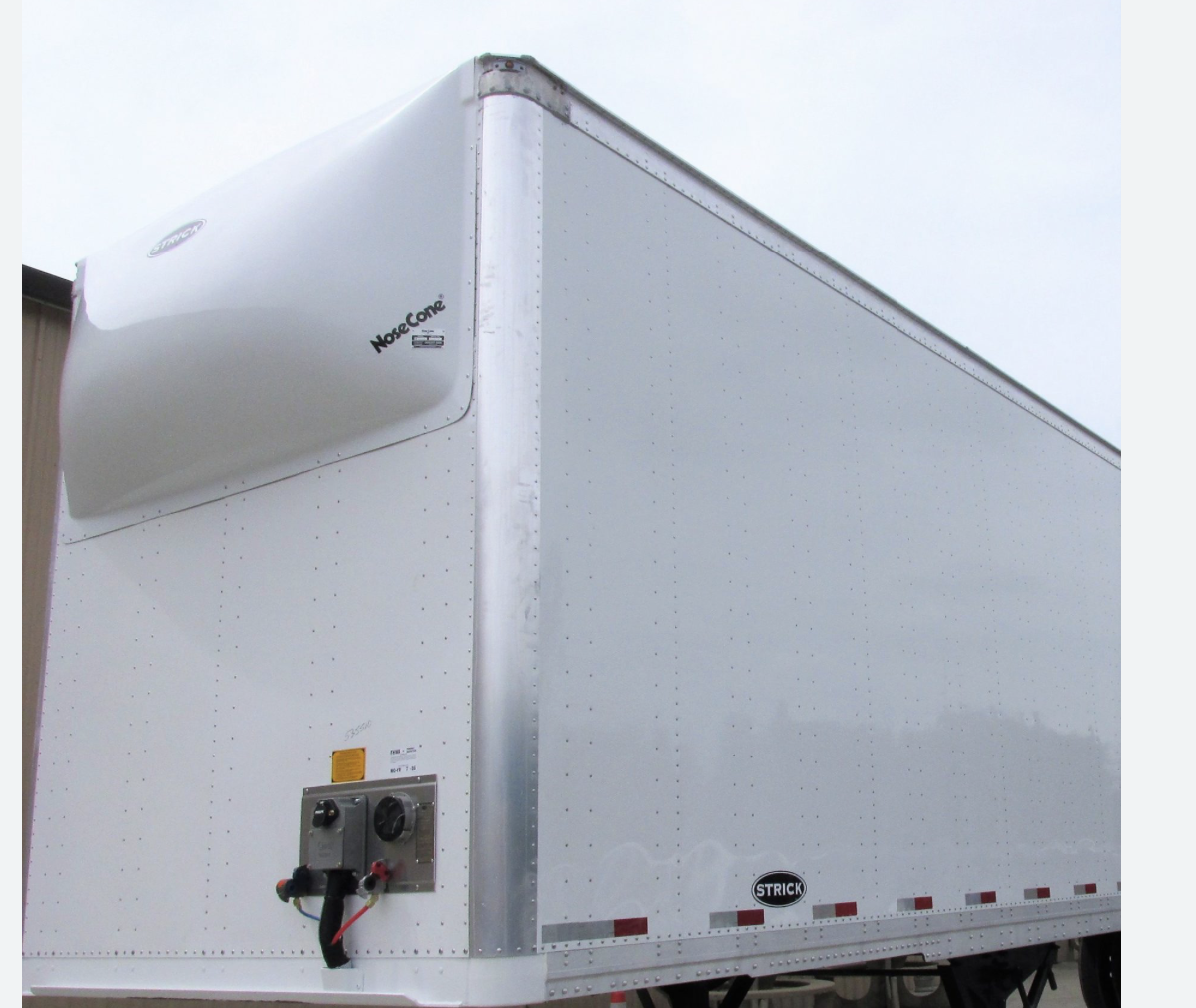

    Brand new trailers have these on them. Nosecone

    I ordered brand new trailers and I was not able to get them. Maybe a mega fleet or somewhere else in the country could but I wasn’t able to in the southwest
