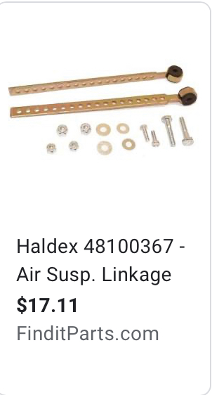

    I would imagine the rod on the leveling valve is adjustable. If not they make rods that are two pieces with a line of punched holes that bolt together.

    @kylefitzy had a rather cheap straight forward solution. Add a quick disconnect retaining pin and you're all set.
