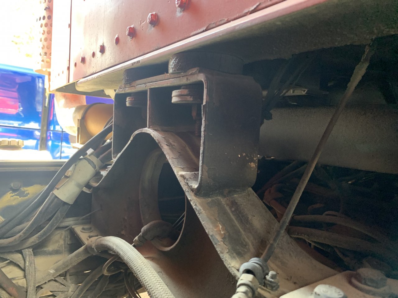

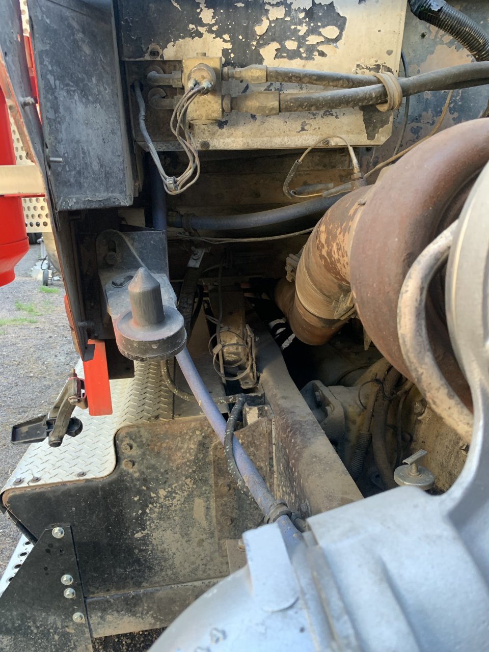

    Can you post a picture of the front cab mounts? Some of the early W900B cabs
    had the front mounts half way back under the cab. If you have that setup you
    can't install an air ride.
    OldRed98 Thanks this.

    Dang… I have the side cab mounts that are under the doors. So you can’t put air ride on this truck?

  9. Inderjit
    Inderjit Heavy Load Member
    742
    721
    Sep 17, 2017

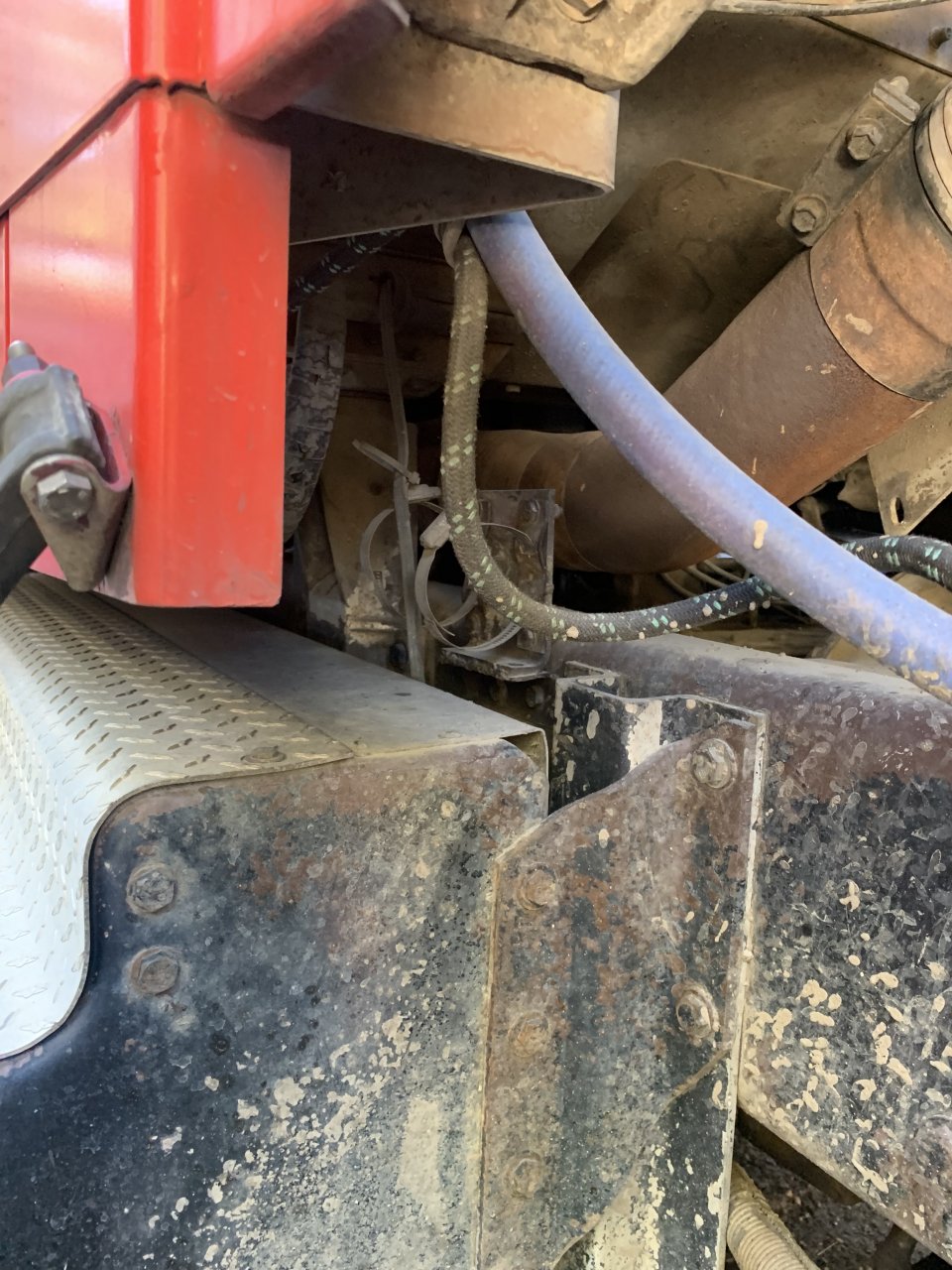

    Can you post a picture from the front of the right cab mount. Its hard to tell
    from that picture. The mid mount cabs had the mounts located in the area
    near the center of the door opening.

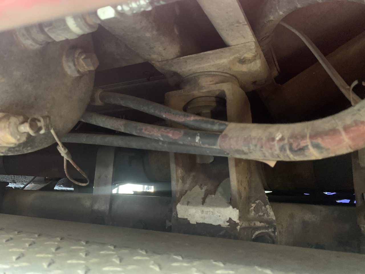

    Thanks for your help. I attached a couple of more pictures. Sounds like mine has those exact cab mounts. Centered under the door.
    I wish there was a solution. This truck is awesome but rides like a lumber wagon. I have an old school air ride seat but its still rough. Maybe a better air ride seat is my only option.
  11. Inderjit
    742
    721
    Sep 17, 2017
    Yes those are the center mounts so you can't install an air ride.
    I worked for a KW dealer when the B model came out and there were lots of
    complaints about rough ride.
    The rear cab mount bushings looks like they have some movement which will
    cause a rough ride. The original rear mounts were soft 70 durometer 2 piece
    mounts. Kenworth tried a couple different mounts and finally went with a one
    piece Lord bushing that was 90 durometer rubber a harder material. They look
    like the ones you have. any movement in the rear mounts allows the cab to move
    forward and back harshly. I would try replacing the rear mounts first and see if it helps.
