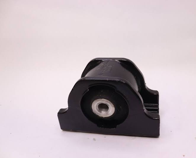

    I think it depends how much you're willing to spend.
    If you know someone that's a good fabricator it's possible to have someone fabricate a set up so that your mounts are at the front of the cab.
    I don't know how other trucks do it but I like the idea that Freightliner has that they pivot on a bushing. If you had the part from a Freightliner that bolted onto the frame if someone could do the fabricating on the cab for you then you'd be able to use air ride.
    The parts are probably relatively inexpensive. I don't know what someone would charge to do the fabricating for you.
