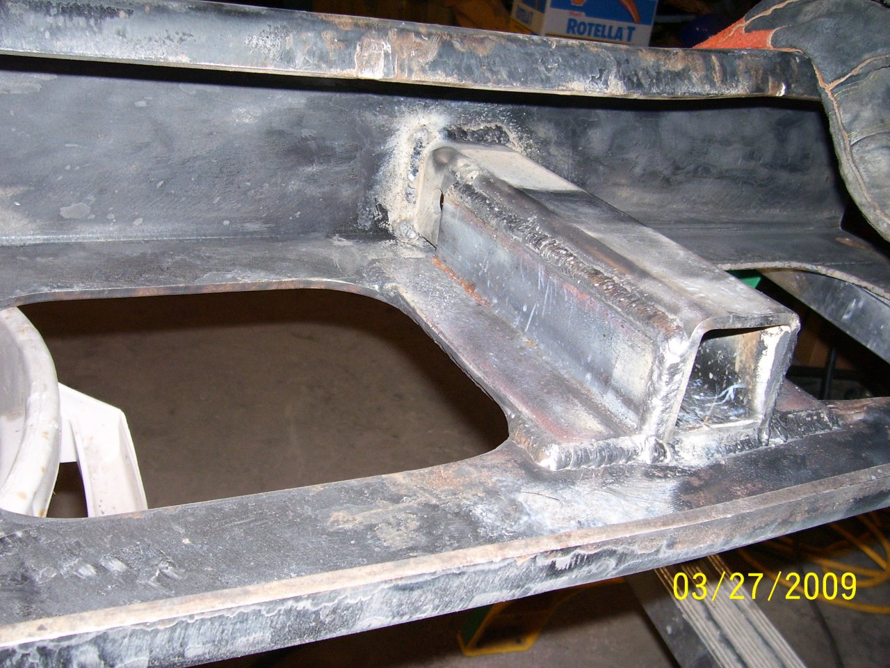

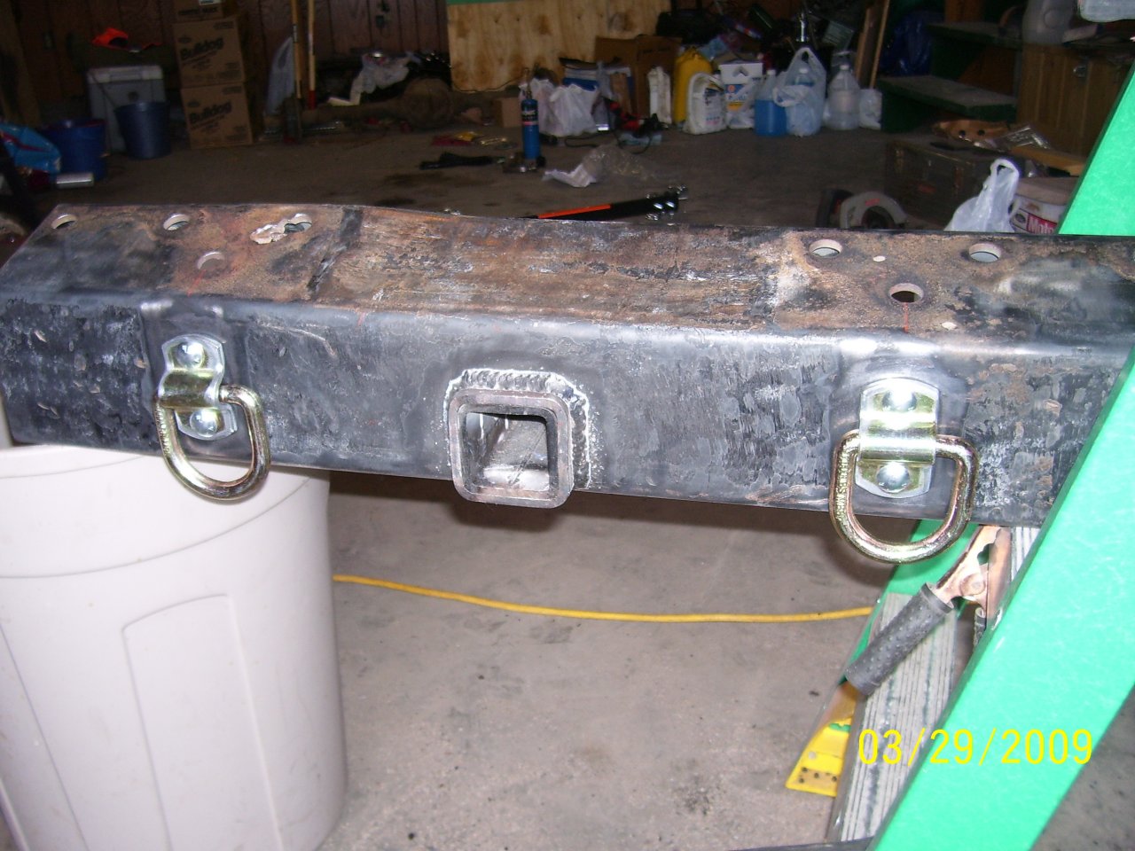

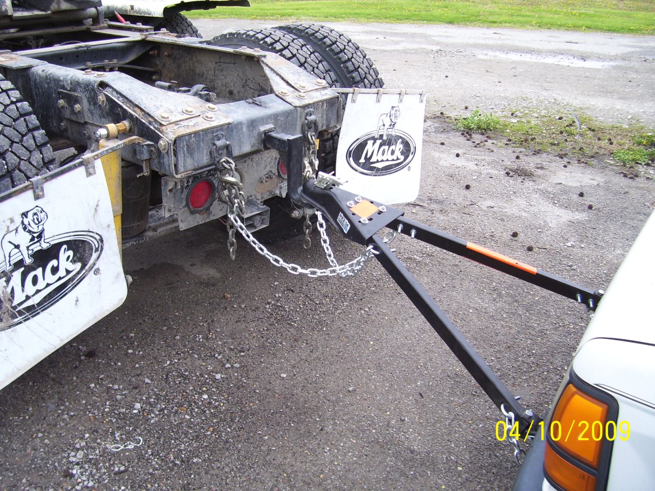

    It depends what you want the end result to be and how much fabricating you really want to do.
    I don't have a photo of it but I made one a long time ago for an FLD 120.
    What I did was I removed the rear crossmember and replaced it with a much heavier tube. Then I fabricated the hitch to that heavier tube. That is the simplest and quickest way to make it.
    It was a while back that I made that, and I don't exactly remember what I did, but I think I fabricated it in such a way that you could take it off of that truck and put it onto another one if you needed to. I did not weld on to the frame. The crossmember was bolted up exactly where it originally was.
    Make sure that your hitch is at the right height so that your trailer sits level.
