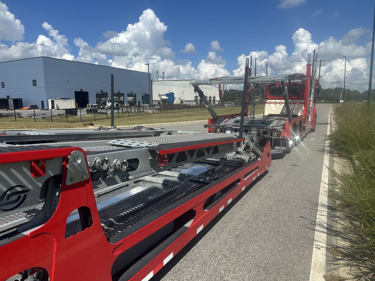

    It's all manual. I have 3 different options. My drive airbags.
    1. Lift the valve up
    2. Raise the airbags on the trailer. I have 4 height levels there.
    3) Worst case but will take longer is: drop the trailer and change the collar, donut, plates to higher height. I have only 2 options there.
    I tried using the lower level on the collar and that was a mess. The way my ramps are (2 inches lower than the deck/well), they were dragging dirt everywhere on dips/potholes. My guess is that I don't have the right truck because my fifth wheel is only 43 inches from the ground.

    Sounds like you know your options and how to use them if you need to get out of a bind.

    I believe they make different heights of 5th wheel risers.

    Just get some fifth wheel risers…..

    Thank you! I looked into it just now, and I will definitely get this done sooner rather than later.
