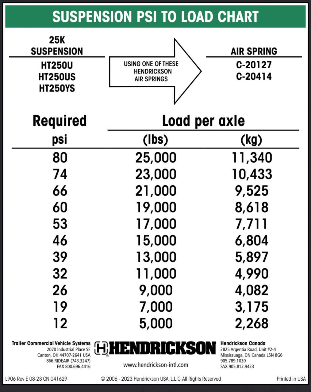

    In regards to my gauges: My trucks drive suspension goes 50-60-70-and then 120. Right at 60 I’m 34k right at even a little past it I’m 38k. After the 70 I have no idea because it’s a wide open space until 120.
    My trailers suspension gauges I am working on. All the numbers that equate to pounds have been weathered out. Plan on using web resources/AI and worst case calling the manufacturer. It’s been pretty heck tick for me.

    For your trailer this chart should be pretty close. You can probably crawl under the trailer and look for the ID number on the airbags and compare it to the 2 in the top right of the chart.

  9. AFC
    AFC Light Load Member
    263
    351
    Jan 1, 2024
    Wow. Thank you!
