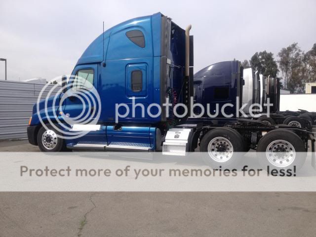

    Is this possible currently truck does not have fog lights and has the plastic bumper ends also can I paint these bumper ends or would I need to buy a different kind to have painted?

    Yeah there's no way I'm attempting it myself I was just wondering if I could take it to a shop and have it done or if it would be too much work...
    I just hate how the front bumper isn't color matched I mean it's not a necessity but i don't like the way it looks
