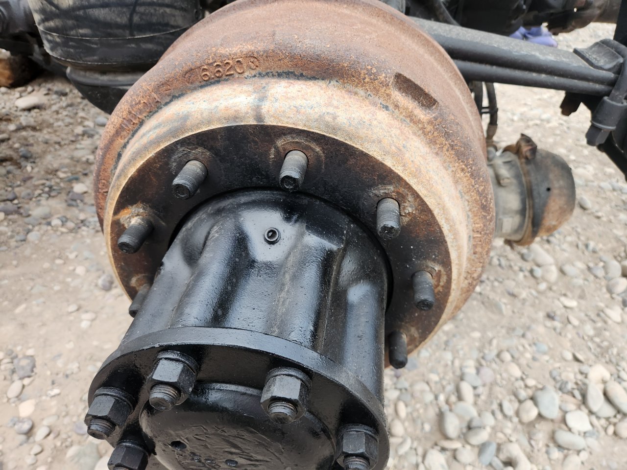

    Here's one that we are rebuilding. I wonder if having the brakes set when the wheels are off might skew the drum center?
  8. BoxCarKidd
    BoxCarKidd Road Train Member
    4,449
    6,495
    Aug 26, 2014
    NOOOOO.
