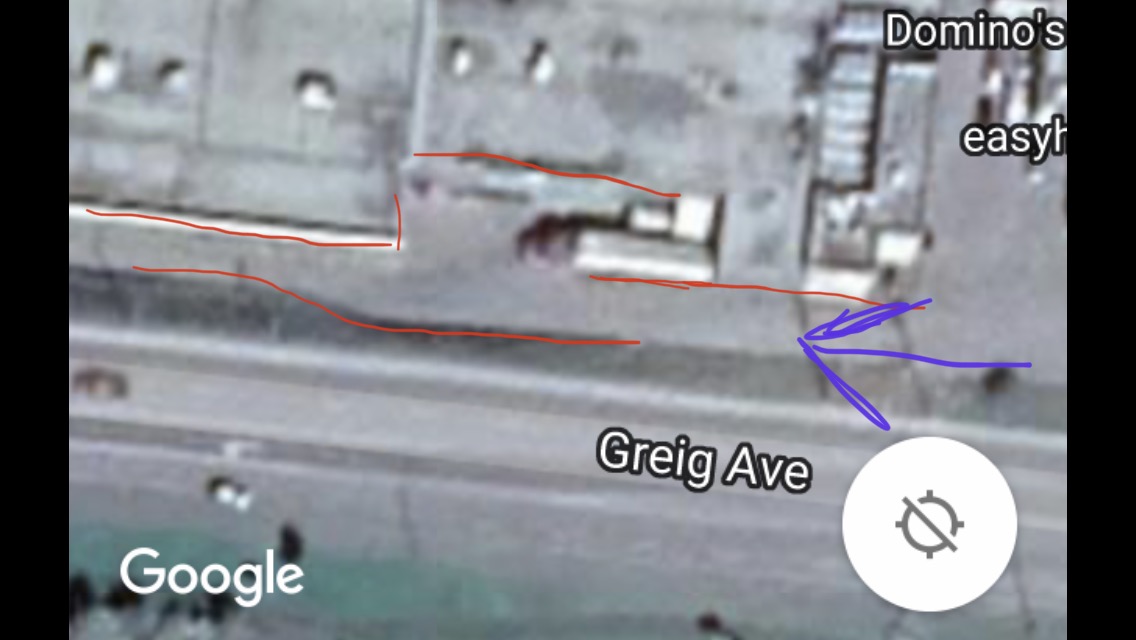

    Hey everybody,
    I’ve had a CDL since 2006 and have not driven since 2013. I’m getting back into driving, but I don’t have a great deal of experience backing into the docks of retail outlets that require precise backing.
    I’ve uploaded a google satellite image with this thread of the location and need advice on how some of you might approach this. I’m driving a 48ft trailer with a tandem day cab. The red lines on the image indicate walls or barriers and the blue arrow indicates the direction of travel/approach.
    Any advice or diagrams on how some of you might approach this would be appreciated. Thank you very much.

    Thats a blind side dock. If I can understand your picture correctly.
    If it was me I would nose in half way between dock and far wall then swing out missing the far wall until trailer is more or less in line with the dock or somewhat pulling out to the left. (Which is not bad.)
    Then back in carefully Getting out to LOOK CONSTANTLY. I cannot tell you how much I believe in getting out 1000 times to check 10 feet backing, Then another 10 feet just to be sure not to hit anything.
    At some point you will be straight with the dock and then you know you have it. Generally aiming at the far left side of the dock edge plate with your left trailer. But all of your eyes to your entire right side and your entire front end AS WELL AS YOUR DRIVE Wheels. IF you have any angle at all to your trailer that last drive axle tires will find a way to hit something. Thats the reason to constantly get out and look on that side.
    IF during this your trailer starts coming out backwards to the left outside of the exact line to the edge of that dock you are jacking her too hard too long. Just do a nice pull up rolling on that line. Looks like a nice 40 foot of pavement or so in front of you there.
    This is not about looking good, showing off or any of that. Blind side is a chore and I hate it. Because at some point I might gamble that the corner I cannot see is where I think it should be. ONCE IN A WHILE if I did not GET OUT AND DOUBLE LOOK TO CHECK I would have hit something or someone with it. if you don't know exactly where all of your corners are stop right there and do a walk around and find out.

    You're making a simple thing too hard. Its just a parallel park with a wall added. Just pull past the opening, about 3' off the right side wall and back into that opening while avoiding the wall between the dock and the street you're coming in on.
    Once you're inside the wall, theres enough room for a pullup to straighten things out. You can even see the rubber pavement marks on your photo showing what every other truck has done getting on the dock.

    Thanks a bunch heavy, I know exactly what you’re referring too. Certainly gonna take me a few tries but I know what you mean. Appreciate it!

    Hey truckdriver 31, you can do a search for Save On Foods in Terrace, British Columbia, Canada which is attached to the main mall here and you should be able to see the dock on the Greig Avenue side of the mall. Thank you!
