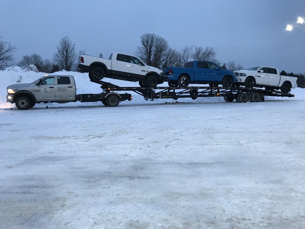

    Ram 3500 or 4500 and 5500 are good. I have 5500 cause I was thinking to upgrade to 5 car trailer.
    Oh and important thing. The numbers I said above is only possible if you have CDL.

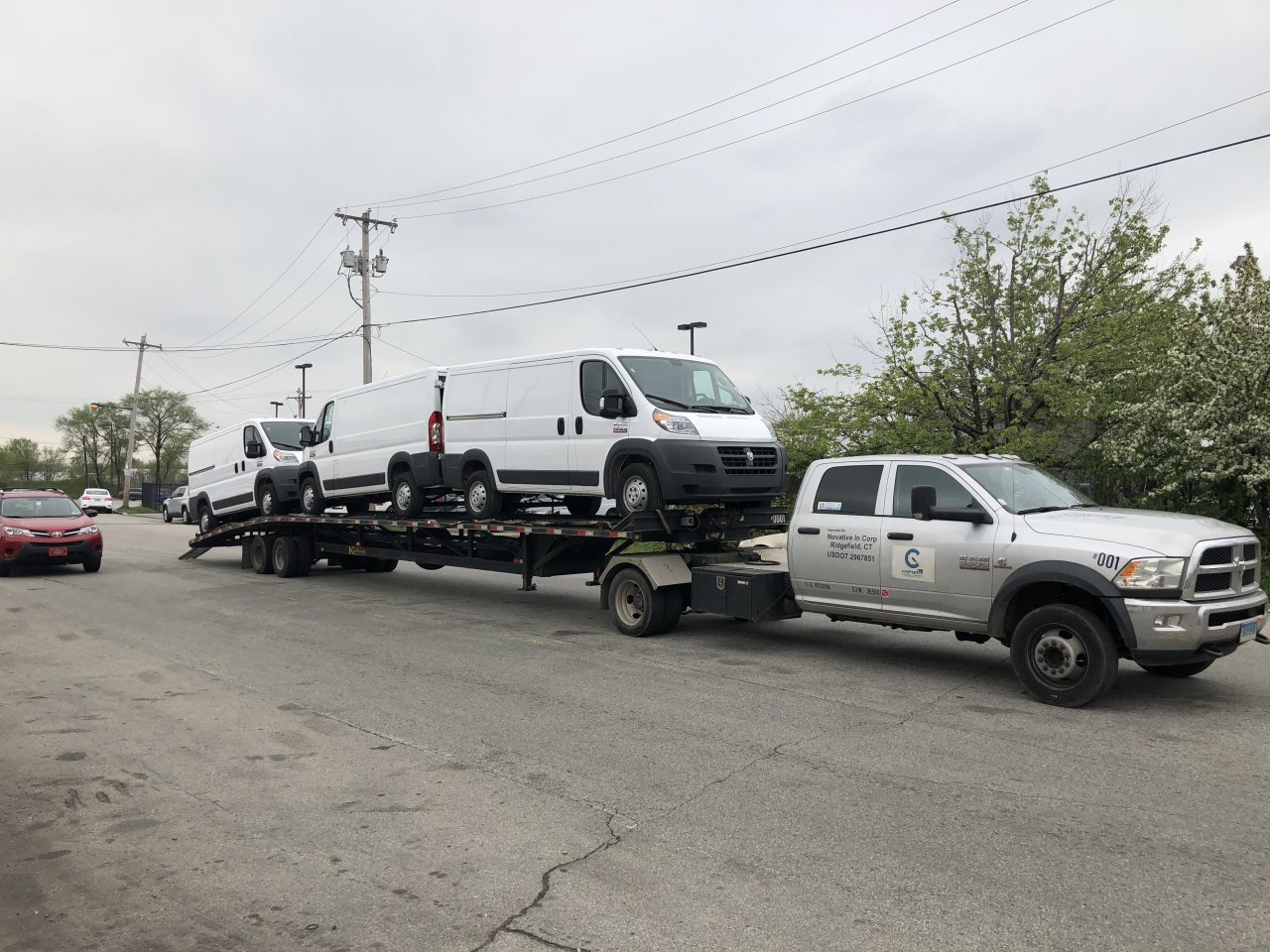

    9 car trailer can take 3 promaster cargo vans and I can do the same :D
    I was hauling 3 promoter cargo vans from Newark NJ and North Kingston RI and 9 car dudes were hating me cause all they could pull was same number of vans.
    Amazon made us good business this winter, no joke I really grossed like 9 car local trailer. I am not just speaking on my behalf I have taken company drivers from new car hauler companies like United, Tribeca and made them owner operators of 3 cars and they are happier.
    But again YOU NEED CDL FOR NUMBERS I AM TALKING ABOUT. YOU NEED TO BE 40 000 GVWR. THAT'S WHY I HAVE RAM 5500 AND LOW PRO KAUFMAN.
    EVEN THOUGH I WILL TELL YOU KAUFMAN IS TRASH, BUT IF YOU ARE GOOD IN MECHANICS AND ELECTRIC STUFF YOU CAN HANDLE AND MAKE IT WORK FOR YOU. KAUFMAN AXLE FAILED ON 100 000 MILES ON MY TRAILER, I PURCHASED ENTIRE AXLE ON EBAY FOR $1000 AND CHANGED AXLE MYSELF IN THE TRUCK STOP IN 4 HOURS!!!!! OTHER THAN THAT KAUFMAN IS CHEAPEST PIECE OF METAL, VERY STUPIDLY ASSEMBLED BUT IT WILL WORK FOR YOU
