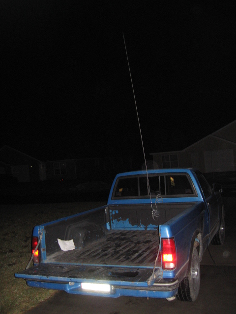

And if you think a 5 foot tall antenna on top of the roll bar is too big, have a look at the 102 I had in my truck....Attached Files:
American-Trucker Thanks this. -
That is actually one of the things i was considering if i do the roll bar to put it on there. Thanks for posting that pic, that why I don't want the 102 for one its huge but it just would look good on my truck.
