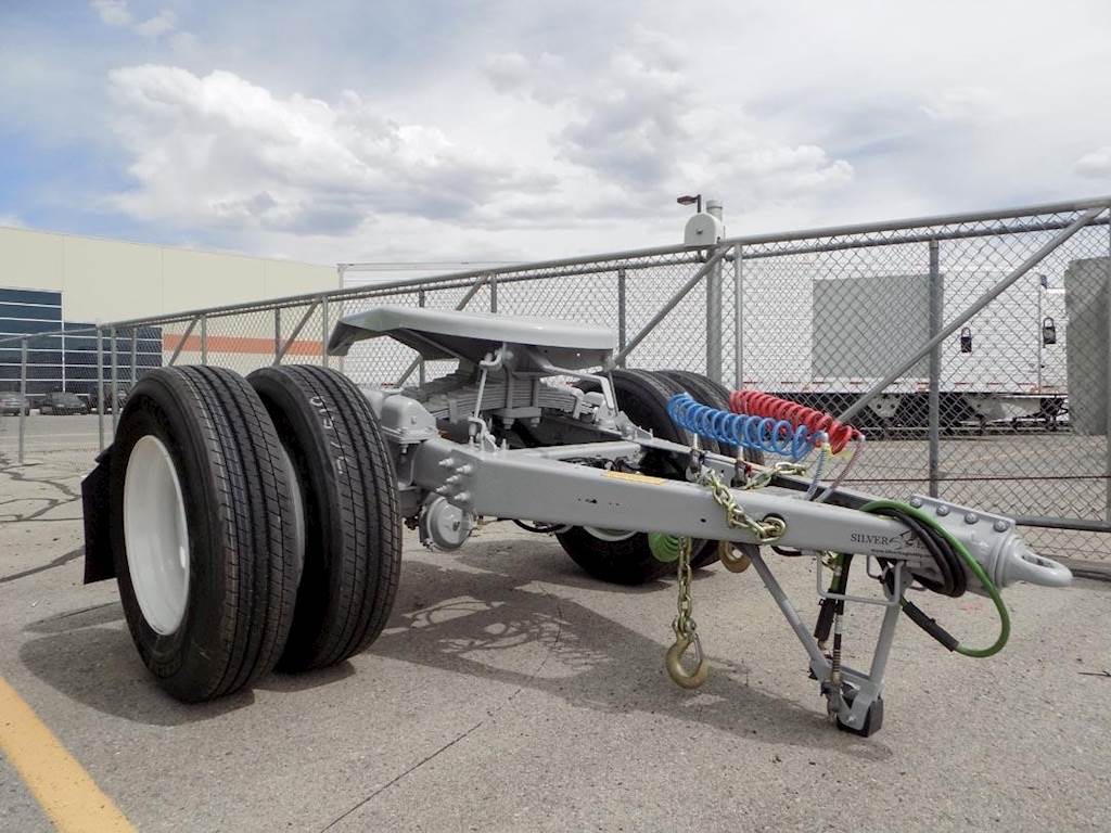

    If your company has dollies like this, use them. They're light and easy to handle.
    McUzi and rowekmr Thank this.

    When I would find a good Silver Eagle at FXF I felt a desire to protect it with my life. If I managed to find one with super singles I'd hide it when I finished my run. I hate super singles in general but being able to maneuver the dolly with one hand and zero strain was amazing.
    rowekmr, MACK E-6 and Speed_Drums Thank this.
