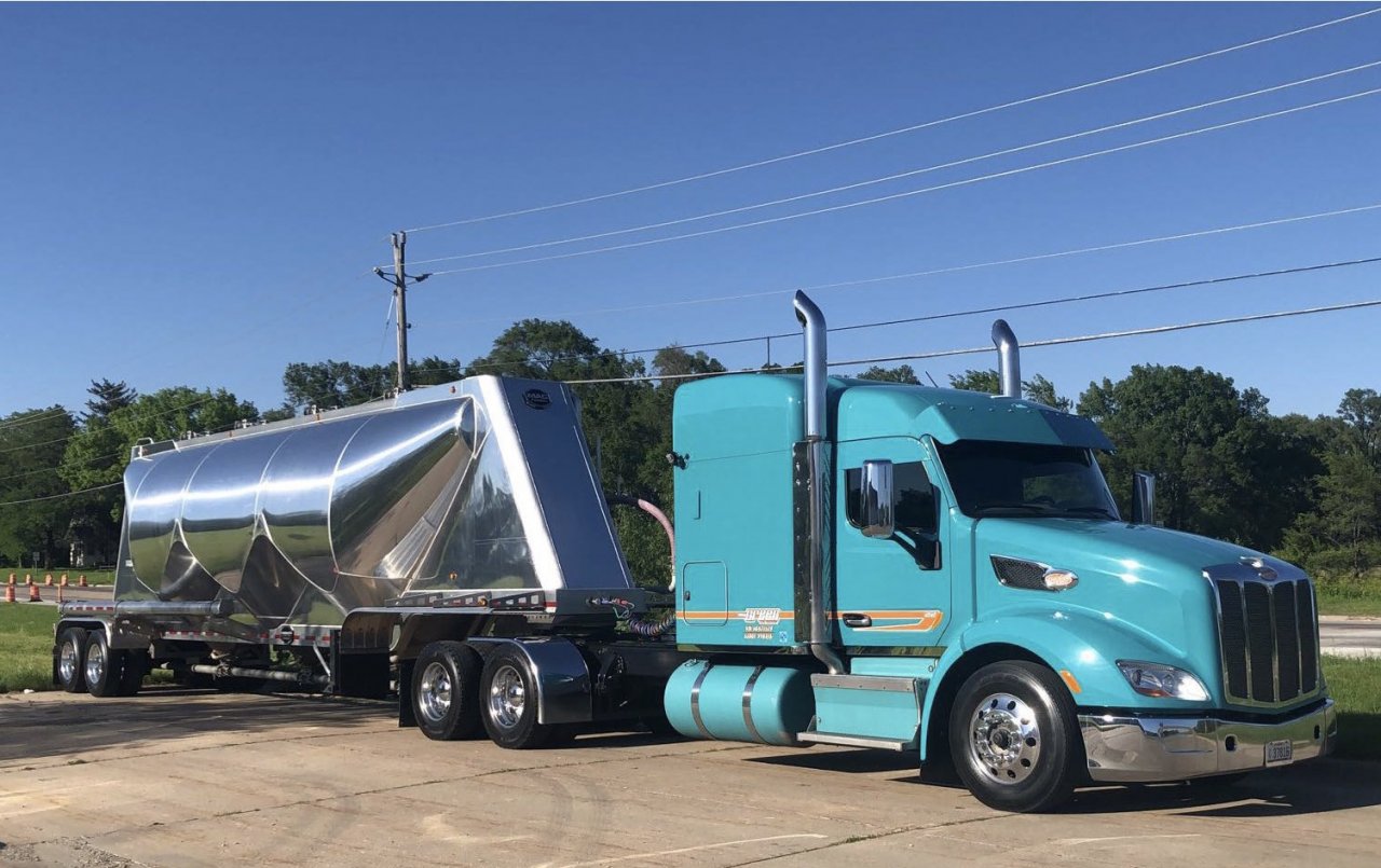

  6. W923
    W923 Road Train Member
    1,387
    4,258
    Feb 28, 2022
    Might be an aero truck but still a nice looking ride….specially with the shiny pneumatic behind it
