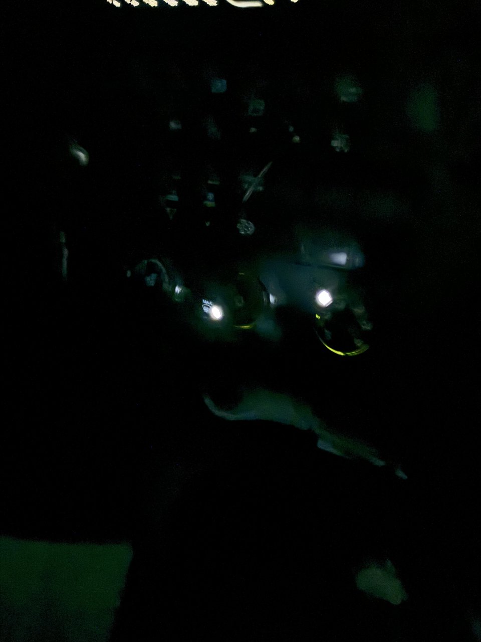

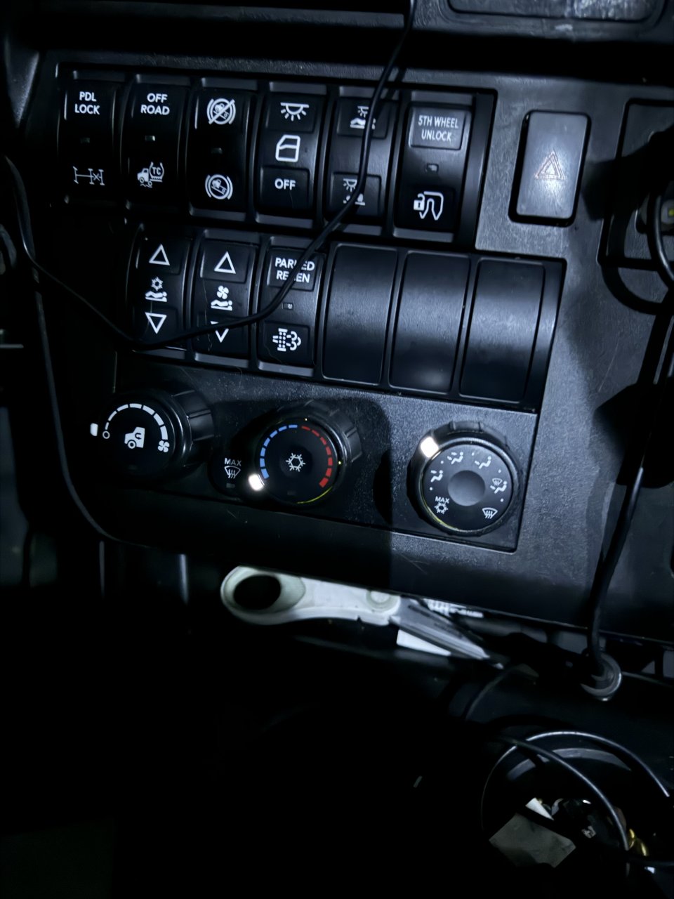

    I took this picture to better explain my original post. It’s dark to illustrate how the blower/fan speed knob is off, the temperature and directional knob is illuminated. As it does this on and off IMG_0177.jpeg cycling, it’s blowing hot air out the vents which cannot be turned off.

    Right now I’m doing a test while I wait for the Love’s shop to open. Current voltage is 12.6-12.5 volts. The lower voltage is when the eAPU AC compressor cycles on. Once the AC compressor cycles off, the voltage goes to 12.6 volts. It will continue to do this until 12.3 volts are reach which then shuts off the eAPU and the truck will start. Nevertheless, as shown in the picture, I notice the control module on the dashboard does as shown in the pictures. The front vents are blowing heat while the back vents are blowing cold air. I can smell and feel the heat. This why I’m guessing it’s electrical and possibly due to improper charging due to the mixed battery types. Because the problem is progressing worse, I want to take care of this issue before major damage occurs. The dealership wants $750 just to diagnose the issue and they say it’s ok to mix battery types.
