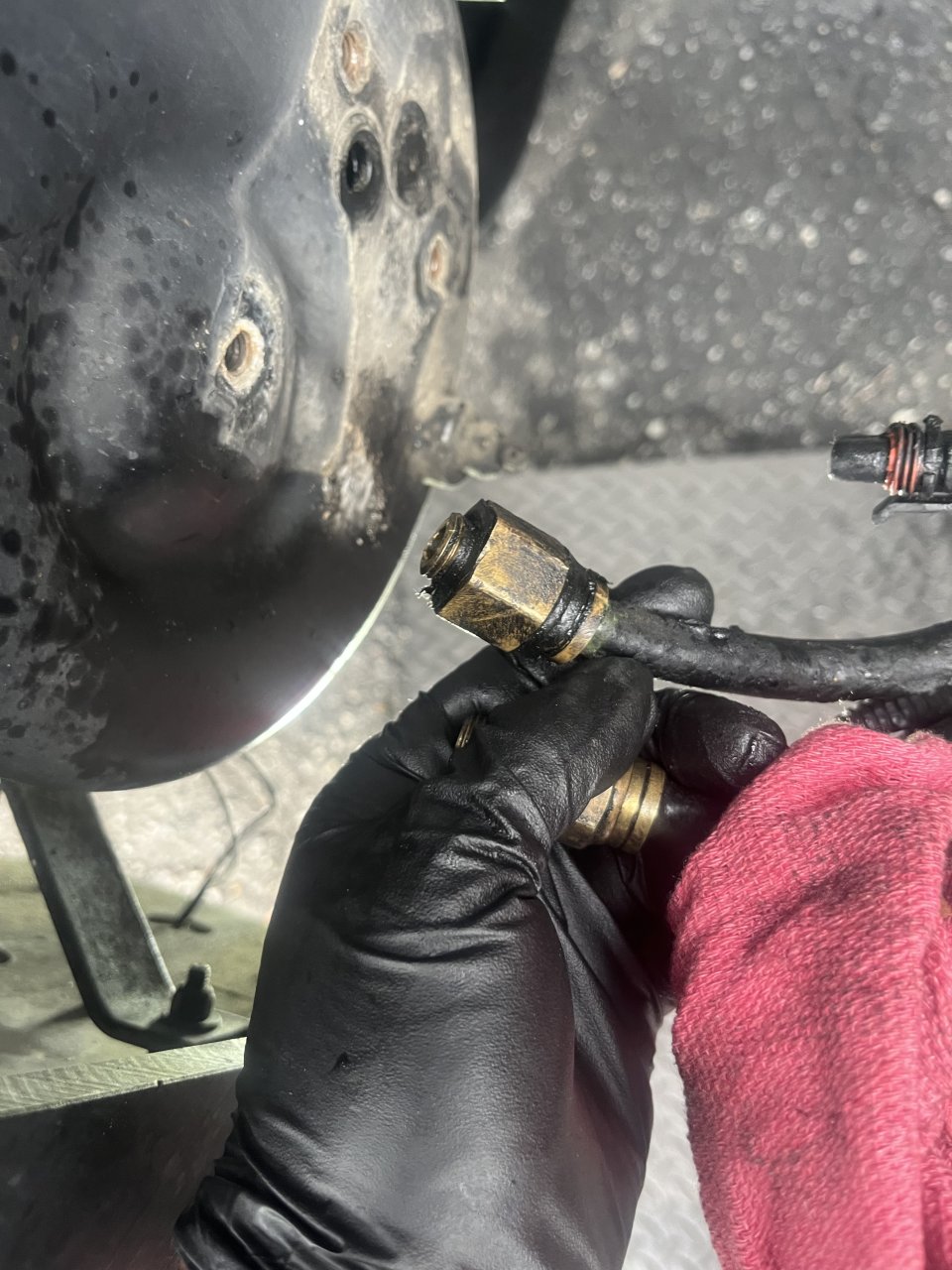

    IMG_3100.jpeg Is this a quick connect of some sort?? I broke it :-(

  5. 062
    062 Road Train Member
    6,288
    33,827
    Oct 20, 2013
    Yes,the size is generally stamped on the collar. Looks like 1/2”

  6. nikmirbre
    nikmirbre Road Train Member
    5,554
    10,210
    Jul 27, 2011
    High Point NC
    That’s gonna be fun to remove….

  7. 062
    6,288
    33,827
    Oct 20, 2013
    Heat and extractor should get it out. Hopefully it’s not cross threaded.

  9. nikmirbre
    5,554
    10,210
    Jul 27, 2011
    High Point NC
    It’s male, so it screws into the fitting so I’d have to get a new quick connect. So that has to come off…..

  10. 062
    6,288
    33,827
    Oct 20, 2013
    If you have enough slack in the air line, you can cut it flush with the collar and take it with you to get a new one.
    Use a sharp knife to cut it.

  11. nikmirbre
    5,554
    10,210
    Jul 27, 2011
    High Point NC
    Actually, I ended up changing the quick connects on both lines. 1 came off no problem, the other I cut and added some line with a union. I finished up yesterday afternoon and after changing the governor and air dryer, the air was still building up to 140-150 on my primary and about 125 on the secondary. I didnt get a chance to get any alcohol poured into the inlet line( it was dark). Ill delve into it more after deliver(checking lines between the compressor and air dryer).
