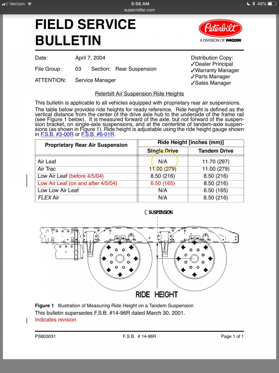

    Hi all, I’ve done my research and haven’t found the dimension for the single axle set up. The bulletin says N/A....? This is on a ‘99 379 short hood. Thanks in advance for your input. A47A55EA-419F-462D-9E34-728457C5F154.jpeg

    Whats the last six your S/N?
    The fact it isn't on there makes me think they didn't sell a single axle with air leaf.

    Start at the tandem ride height. Factory angles were 4.0 on the front drive and 11.0 on the rear. Since you are moving the rear to the front I would look to get the axle to 4.0. This may require shimming as the forward and rear axle shims are different.
