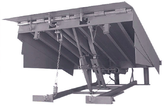

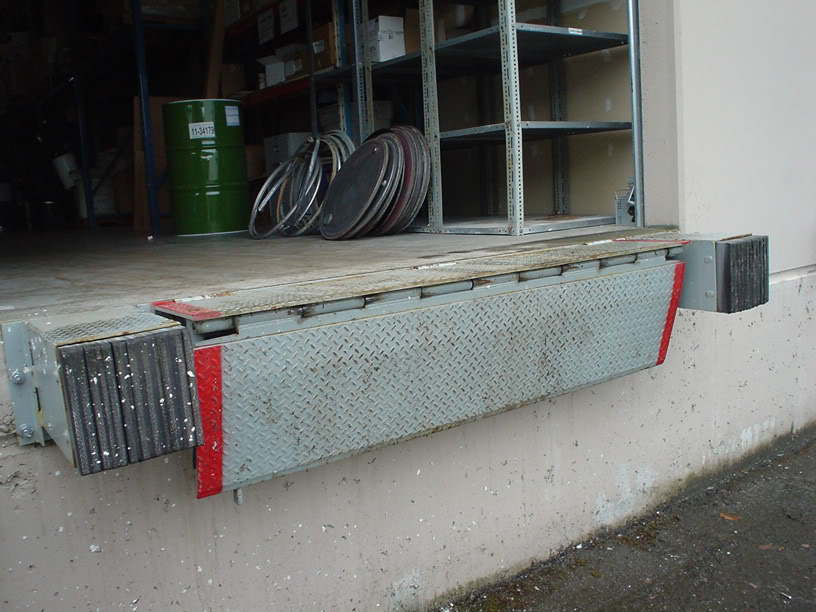

  11. MACK E-6
    48,145
    219,803
    On this kind of dock plate, that's not a problem.
    These, however, are a different story.
    dancecanyon and 25(2)+2 Thank this.
