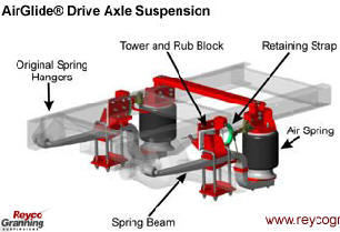

    I get what you are asking, here is an air ride suspension illustration that may help.
    This is the most common way the rear suspension is configured.
    The spring beam is where the axle mounts to and you can see the u-bolts.
    The following is a typical leaf spring suspension illustration.
    the u-bolts are used to mount the axle to the springs.
