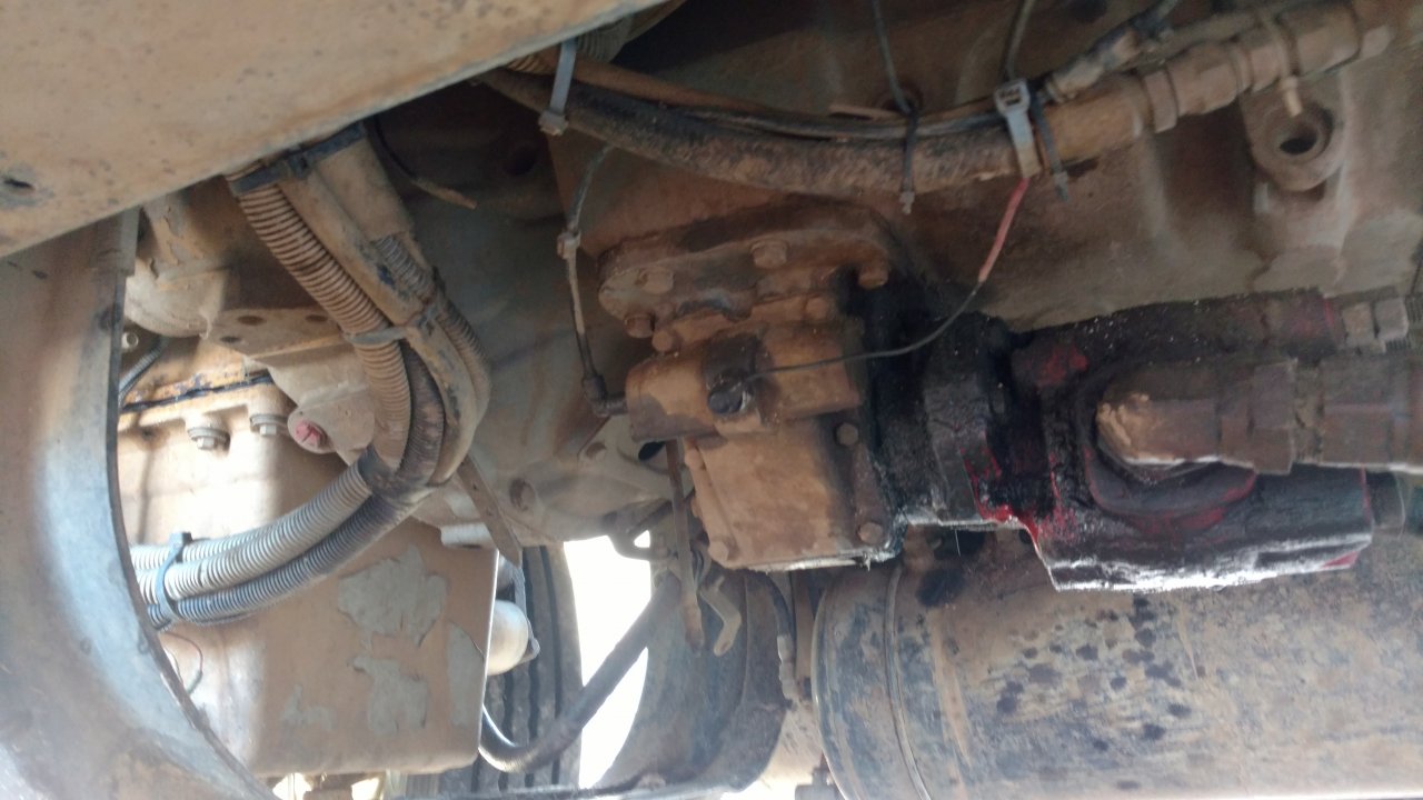

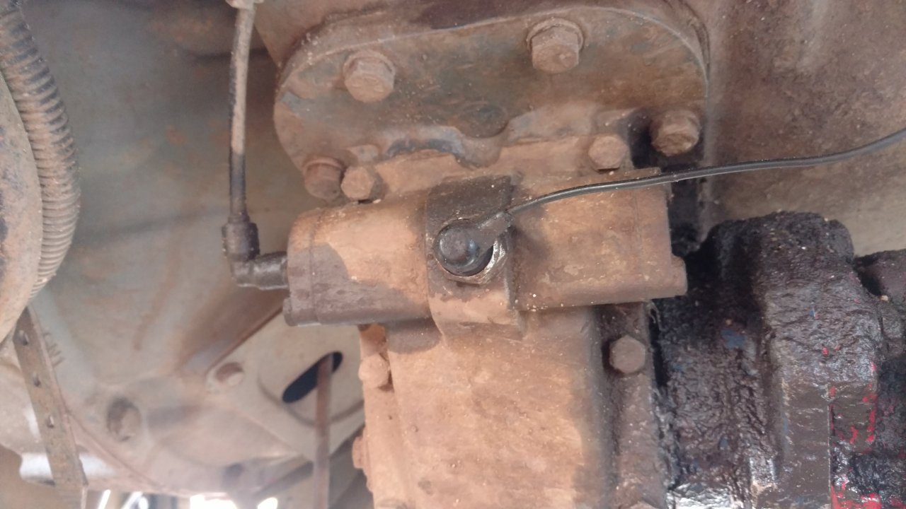

    Well, when you first turn the key on and the air pressure is low, the PTO is engaged, and the warning light on the dash is lit. After the air builds to about 60 psi the PTO will disengage and the dash light goes off. The load on the truck is noticeable as it turns the hydraulic pump. It is not a tremendous load as the pump is just cycling oil at this point, but it is noticeable.
    Here are a couple of pictures of the air shift mechanism attached to the PTO.
    There is a cap on each end; one of which contains the fitting to receive the air line. I am wondering if I can swap the caps from end to end, and probably reverse an internal spring, to get it to function so that it requires air pressure in the line to engage it. I am not sure what I will find inside, and also not sure if I will have to drain the trans fluid to do this. I don't think so as it should be separated by the PTO.

  7. snowman_w900
    4,418
    81,025
    Nov 25, 2010
    That's a Muncie. That should Be an easy one to correct. Just to double check the operation, I'd pull the airline off once it's running and see if air is coming out and verify the shift mechanism kicks the pto out once the air is removed from it
    Then I'd replumb it to a normal setup.

  8. wore out
    wore out Numbered Classic
    17,551
    219,382
    Jun 5, 2013
    CHASIN THE DEVIL'S HERD
    I haven't seen one of those, but I am thinking like you what if you swap ends with the caps and maybe a spring?

  10. Oxbow
    Oxbow Road Train Member
    13,747
    142,622
    Nov 24, 2015
    Thanks gentlemen, I believe I'll try that. I should be able to remove those caps without the transmission oil coming out, correct? (I know you two have a sense of humor, perhaps I should ask someone else?)
