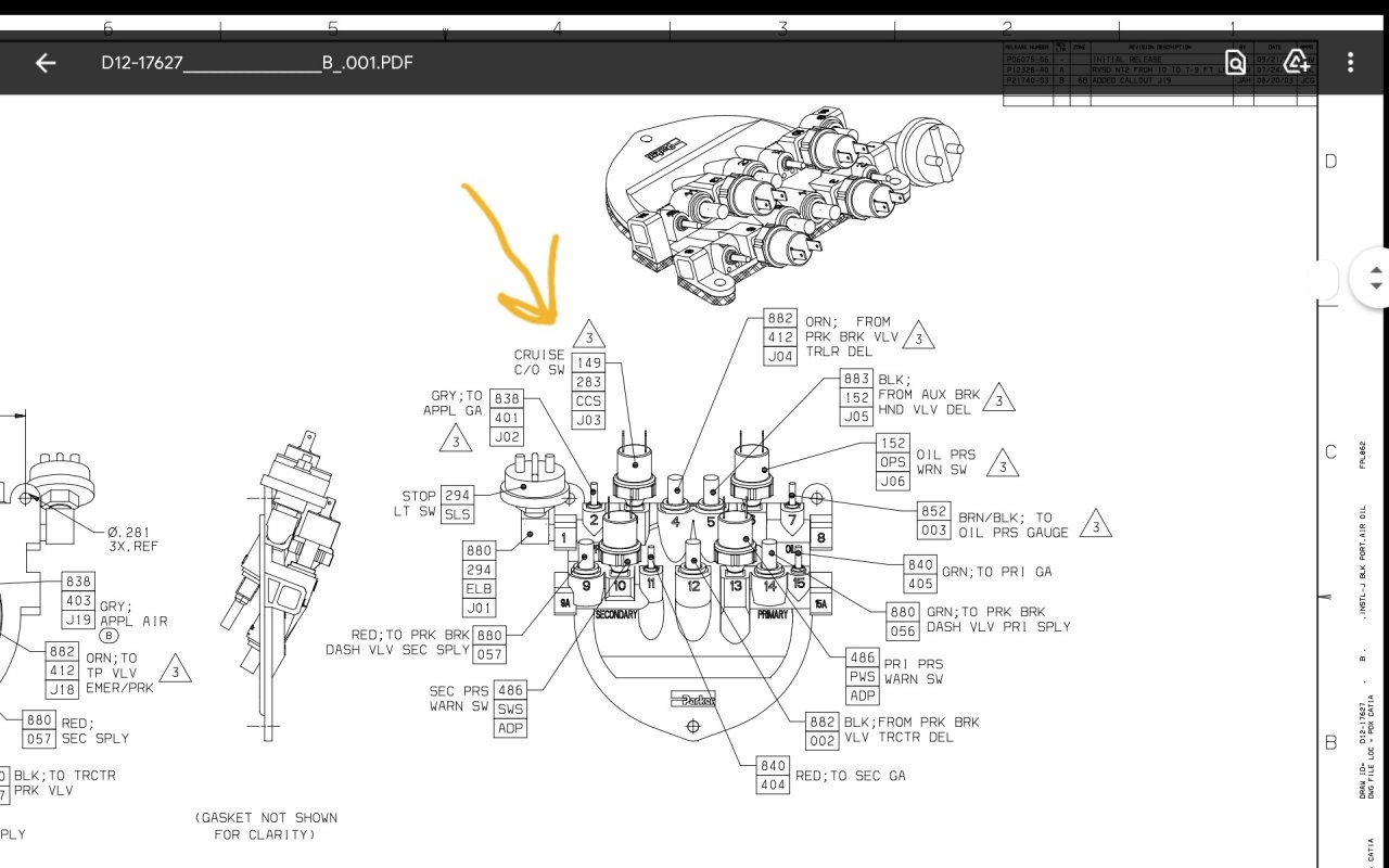

Hello. I have 2001 freightliner FLD 120. Previous mechanic did a shoddy job with air switches. I have looked everywhere for a diagram and videos to identify which air switches go to ports # 3, 10 and 13. Can anyone help me? Thank you![]()

This manual is huge but I used it. I had a problem with one of the switches on the manifold (brake application switch) and it messed up the cruise control.
http://manuals.chudov.com/Freightliner/Freightliner-FLD-Service-Repair-Manual.pdf
You just need to find the right page.iledbett and QUALITYTRUCK Thank this. -
Yes, I did. Thank you!
