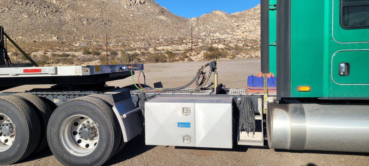

    What do you guys think of this? This is my truck, company assigned. I always thought nothing can touch the catwalk. Am I wrong? Every truck in the company has this same setup. IMG_0669.jpeg

    As long as they’re protected like that they are fine.

    My concern would be catching a quarter fender or something when jacknifed, but they are protected from wear on the cat walk.

    Yep. Quarter fenders and hucks. Straighten up and break your air lines and eff up the light plug

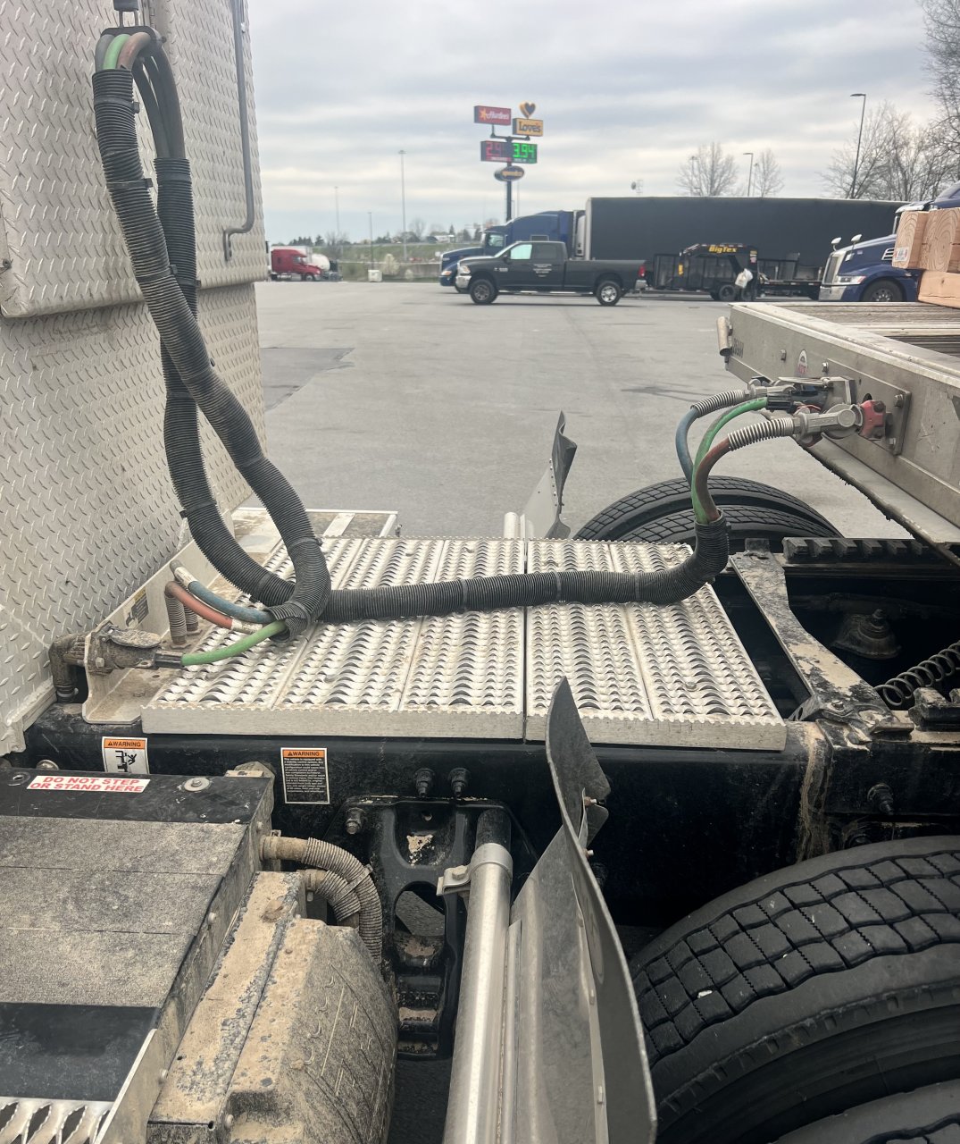

    I have the same problem with mine. I try to put them up with a bungee, but it eventually ends up touching again... I have never had an inspector write me for it but they probably could

    That's the main reason I still use coiled air lines. I've made a bunch of service calls since the 3in1 sets became popular.

    With the overhang you guys run it's tough.
