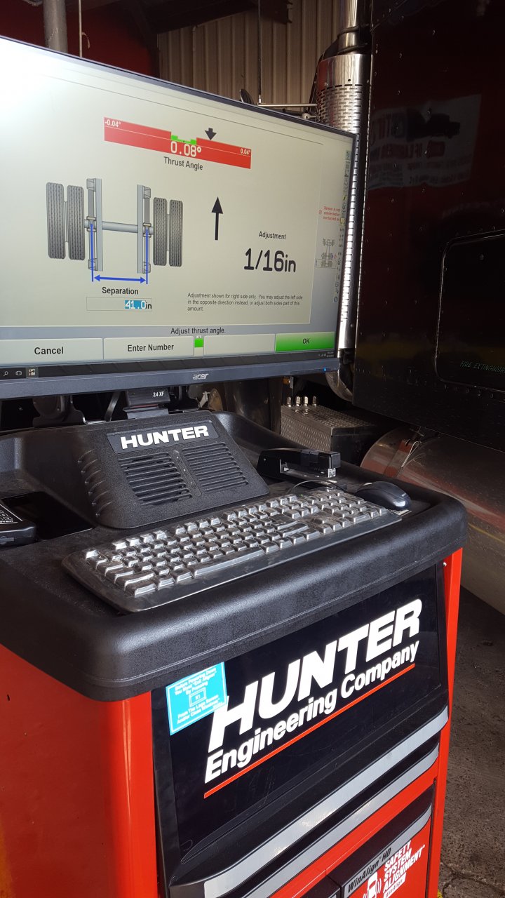

    Come on guys you can't compare a string measurement with a laser.....
    Dave_in_AZ Thanks this.

    That laser is only as good as the person using and calibrating it. You can lean against it and get everything in green if an operator wants to.
    Tug Toy, Hulld, rollin coal and 2 others Thank this.

    And just because it’s “within specs” according to that expensive machine doesn’t mean it’s right.

    Could you take some pictures of the set up you have and post them up?
    I will try to help if I can see what you’ve got.

    Much like a wrench or a screwdriver the laser machines are useless if not used properly.
    spsauerland and lester Thank this.
