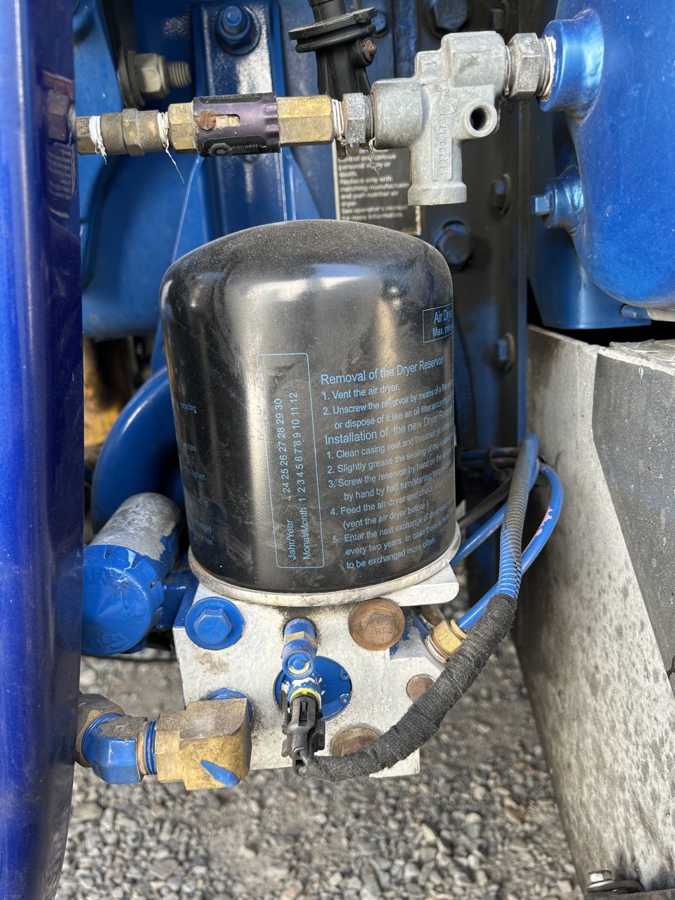

    What dryer, or how many air lines are on it? Maybe a pic?

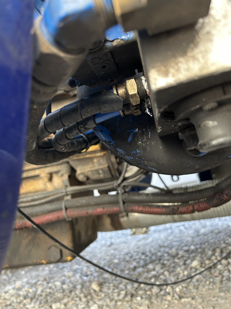

    ADIS primary and secondary outputs are right below. The governor in the front four auxiliary ports in the back has the 10 inch purge tank

    I even tried teeing the two outputs of the dryer together. So primary and secondary were both charged in case it was a pressure problem off the dryer. Purge valve and governor works fine.
